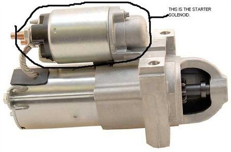

I would agree and it would be the first thing I would check. Just so we're on the same sheet of music... this is what we're talking about.
(not a Corvette starter, but similar in function)
I would remove the solenoid from the starter and check inside. If there is evidence of corrosion inside the solenoid and on the bendix plunger, clean it good and reassemble the starter and try it out. (I would also spray some CRC 556 or similar lubricant on the plunger before reassembling the solenoid.) If it fails again when the engine is warm, replace the solenoid with a new one. This should cure the problem.
Good luck and let us know what you discover... GUSTO
