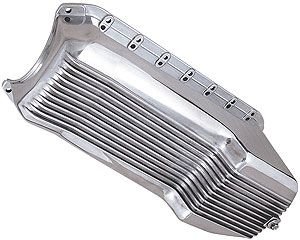

Originally Posted by GUSTO14
That is one sweet pan! Do want!
This is the same pan and stay away from it.......
http://www.ebay.com/itm/SB-Chevy-Finned-Aluminum-Oil-Pan-W-Bolts-283-327-350-1979-86-P-S-Dipstick-V-8-/131753494857?hash=item1ead1ec949
http://www.summitracing.com/parts/ca...make/chevrolet
Click on the 360 degree view.
This one in Summit is black you get the idea.....just an open pan. Same casting.
It has been around since the 80's and is a nice looking piece but has ZERO internal baffling.....when you hit the brake....all the oil flows right up to the front of the spinning crankshaft.....the little cast dam makes little if no difference....
The only way to use it is to somehow make or buy a baffle for it....and i know of none you can purchase...
A friend of mine has one that he is going to use on his 32' Ford Coupe...but he is going to duplicate GM's baffle and TIG it in....
If you can swing it....the original 6 quart Corvette pan is an excellent piece.....it has excellent oil control....some even have trap doors.
Any of the above 5 quart pans will work well.....not sure what they are talking about on the power steering as the original Vette pan sump is even larger.
Jebby
