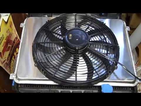

The problem lies with the fact that the "fan doesn't cover the entire radiator."
You need to build a fan shroud that covers the entire radiator and then mount the cooling fan on that.
Kind of like this.....http://img.youtube.com/vi/ub04uaZMVf4/0.jpg

Looks like a baking sheet with a hole cut out for the fan. I guess blocking off the exposed area of the radiator forces the air through the fan, correct?

Pulls more air through it as a whole
Remember to put a number of rubber flaps ie vents in there so when youre at speed the air has somewhere to go or youll risk heating up at hwy speeds.
Google the fan man, give you some good ideas.
If you look at a lot of GM shrouds there are usually open spaces around it for that purpose

Wow, learning alot. Looks like little rupper flaps that lift when driving, but I thought you wanted to avoid air getting around the fan?

The flaps stay shut at idle or lower speeds so you get the full effect of the shroud. When pressure builds up the flaps get forced open and release the air the fan cant pull in.
Those use 3 1/8 in holes and have rubber nubs you just push through the hole to stay put. Cut your holes a little smaller than the flap
Looks like Summit sells them now nothing on Fan Man site anymore. Giants win again...
4 should be plenty
I never noticed that when I was stealing the pic, but it does look like a cookie sheet....LOL
