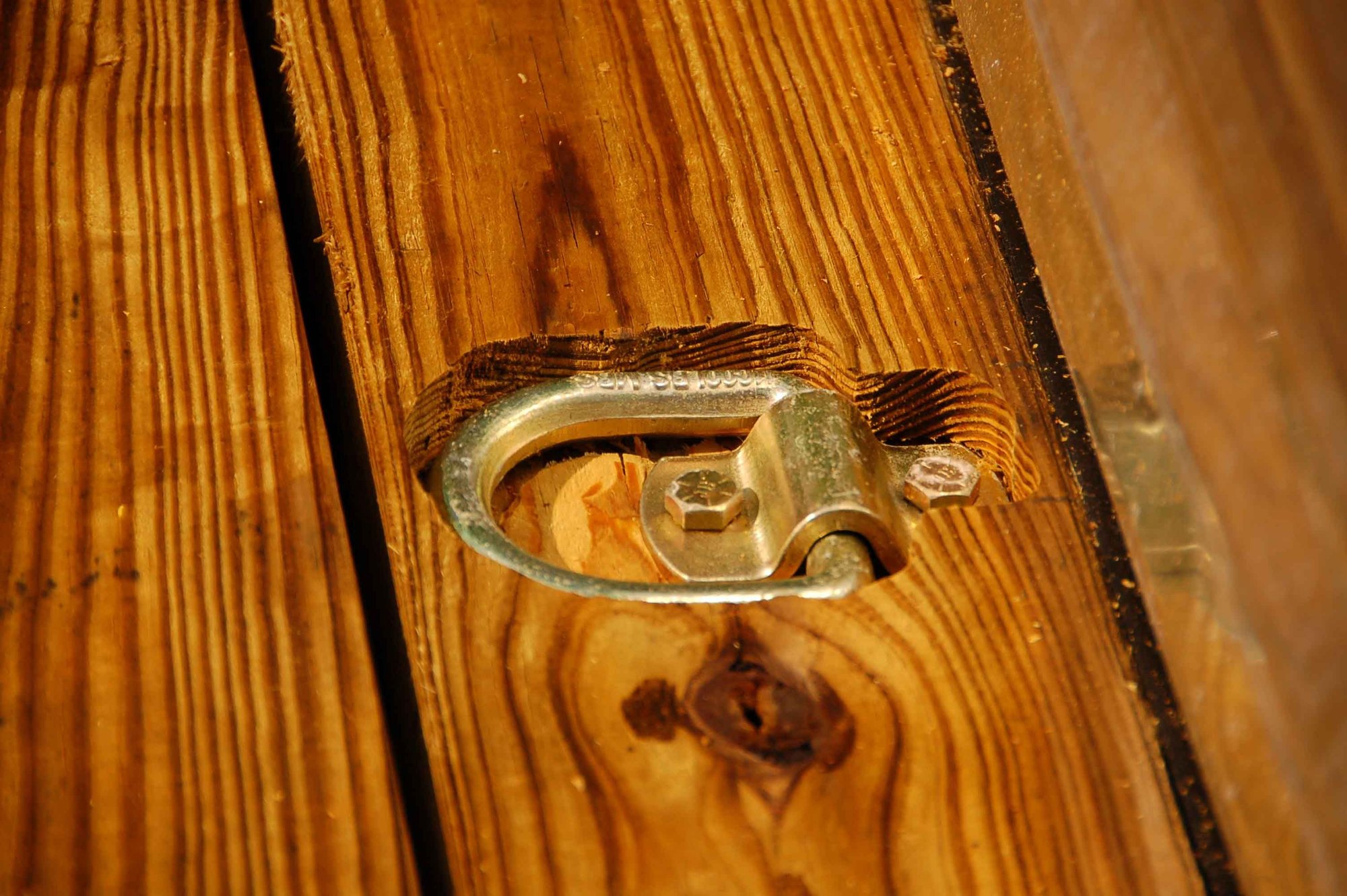

My 20' dovetail also does double duty for my Kubota BX and my 1970 Corvette. As well as mulch, lumber, and whatever else I need.
One of the first modifications I did was to install recessed D-rings on the trailer deck. They are located at each of the trailer crossmembers, so I was able to get two grade 8 bolts through the angle at each location. I recessed them so I could unload mulch without getting my tractor bucket tangled up in them. And I put them on the inside of the trailer instead of the outside (along the rail) so I could carry my tractor to a job and still have my stakesides on the trailer just in case I needed to grab some dirt, mulch, or stone.
The trailer is a 10k# capacity Leonard and I've been very pleased with it. At the time I purchased it, the price difference was a few hundred to go from a 7k# capacity to a 10k#, so it seemed like an easy decision.
I took these pictures in June 2008 right after building the stakesides and installing the D-rings, so its all nice, pretty, and shiny. I still use it all and haven't had a moment's trouble with any of it. This is the trailer I used to get my 1970 Corvette home in January 2012 and I still use the crap out of it.
I originally towed it with a 2005 Expedition rated for 9,000#. Pulled fine. I now tow it with a 2012 F250 6.7L Diesel rated for...well...lots of pounds. Many more than I need to ever tow.
