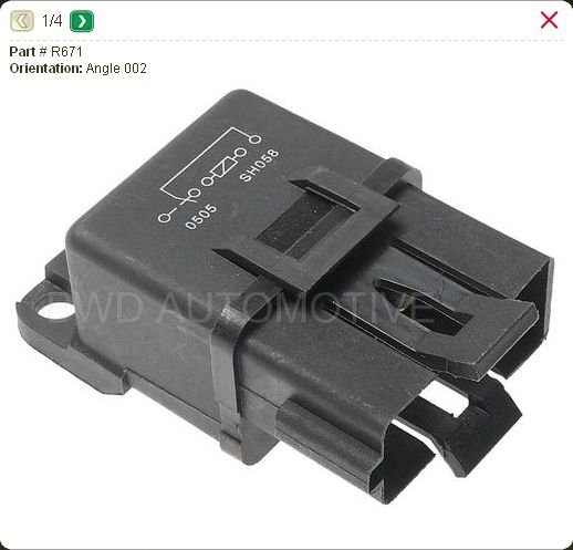

The only practical way to test it is to replace it. I bought one for a '84 from Eckler's, but the BWD R671 and Wells 19844 are probably available locally (O'Reilly's or Advance). Again, these won't bolt in like the original, but they're otherwise the same.

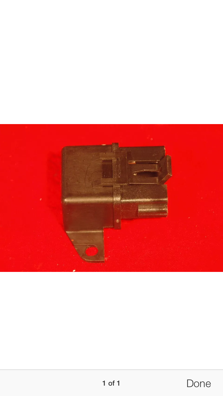

This it?

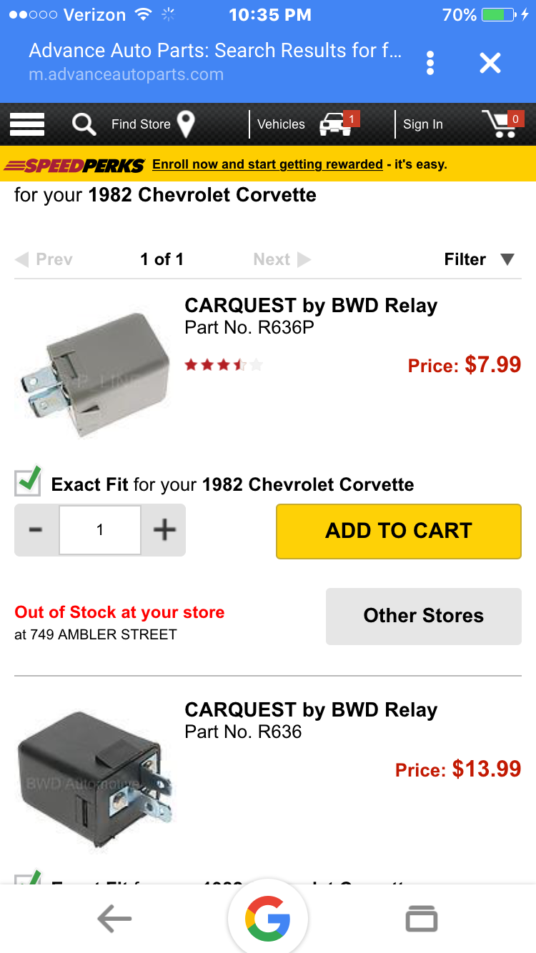

Or are these it?

No, those aren't the right relays. You want a BWD 671 or Wells 19844. There may be other brands that will work, but I've confirmed that these are wired the same internally and will fit the plug. These are listed for a 1984 Corvette. If you look up the relay for a '82, you won't find it at a local parts house.
