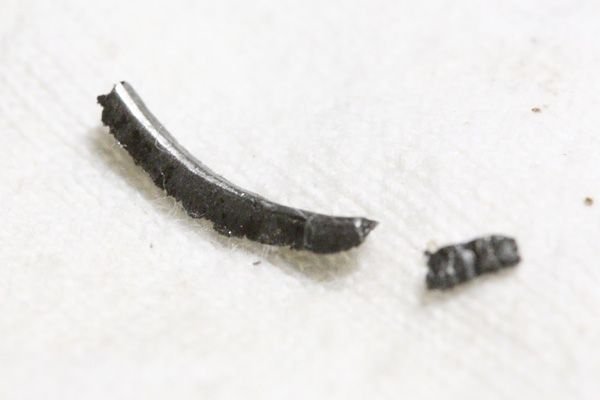

Deja Vu. Saw these same pix months ago. That control valve was broken then and it's still broken now
You're the only person who thinks so. Everyone else - including Wilcox - said it was only a casting flaw.
https://www.corvetteforum.com/forums...is-broken.html
Help me CF! This obviously broken part is the only flaw in my power steering, but it's not why I can't turn right!
Right, I don't think it's likely to be the new cylinder considering this is basically the same symptom. Also, I didn't see anything in the control valve that I thought would cause this. One edge of the bore was broken off, but there's still plenty of smooth bore covered by the piston. Tried a test yesterday when I got home from work with the car still hot. Turned the wheel to the right while at a stop and revved the motor. There was no difference in effort, still virtually no assist in that direction. I think that implies the pump isn't causing this. Guess I'll need to ask my local mechanic to test the pressure for me.
Are you sure there is no additional FOD in the valve seeing how you found some of the pieces already.
Nice roadster Bob!
I was really careful about cleaning out the valve before I reassembled it. The fact that the system works when it's cold has me stumped. Maybe I should replace the valve, just to eliminate it. Something might be worn that I can't see.
