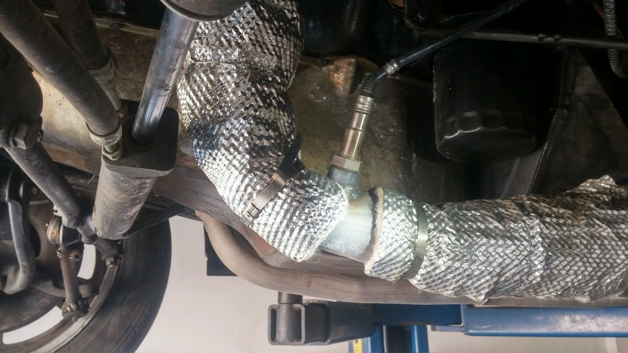

Now that you've started modifying your Corvette, I highly recommend both a quality fuel pressure regulator and fuel pressure gauge, like the Aeromotive unit pictured below. The $29 Holley's will fail eventually and leave you stranded (as I've witnessed a few times already, including personally). You need to know what you're fuel system is doing.
Secondly, I can't stress enough, the superb advantage of having an Air/Fuel Ratio gauge, like the wideband unit, sold by AEM. You will know instantly at all times, exactly what A/F ratio your carb is at, whether it's at idle, 3,000 RPM or Wide Open. Easy install, and they even include the O2 sensor and the bung to weld onto your headers. Way better than guessing and scratching your head at the results. I also run a dedicated vacuum gauge as well, because there's a lot that can be told from that too. I replaced my clock with the vacuum gauge.
Aeromotive FPR and Gauge:
AEM Wideband Air/Fuel Ratio Gauge:
O2 Sensor on header:

Funny you should say that, I have an AEM wideband 02 sensor and gauge sitting on my desk at home! Planning to install it this weekend. I completely agree that having accurate readings is key. I will look into installing a fuel pressure gauge as well. Thanks!
Easy install! You'll love it!
