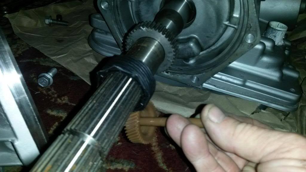

When it came to dealing with the mechanical speedometer, I was faced with either relying on a VSS signal to an electric motor to drive my speedometer or find a way to drive the cable in a conventional fashion...yet still provide the required VSS signal, I came up with a better idea.
This is the 4L60e I built for my 74 Stingray. Pay attention to the rear tailshaft. This picture shows the transmission before the mod, and as it sits it's unable to drive a conventional speedometer cable
The tailshaft on the right is a stock 4L60e from an Fbody (TransAm). The shorter one on the left is what we need. It came from a 700R4 transmission. It has a conventional tailshaft/gear driven speedo connection, but it too short
Here's a better shot at what we need
Here's where the magic comes in.
Here's a shot of the 4L60e tailshaft. It now needs to not only drive a speedometer cable, but it also must provide the VSS signal to the PCM. What needs done is to move the reluctor wheel further into the transmission. This will relocate the VSS sensor and allow me to line up a conventional speedometer gear with the 700r4 tailshaft housing.
Here's a shot of the actual required VSS sensor
Now it makes sense. The aluminum spacer will provide the new location for the VSS sensor as well as take up the space for the shorter tailshaft
this is where the relocated VSS sensor will reside
This puts us right back into where we need to be
This allowed me to install a conventional speedometer cable and even calibrate it for the 3:73 rear gear swap. This also removes the responsibility of driving the speedometer by a VSS controlled electric motor driving your speedo cable
