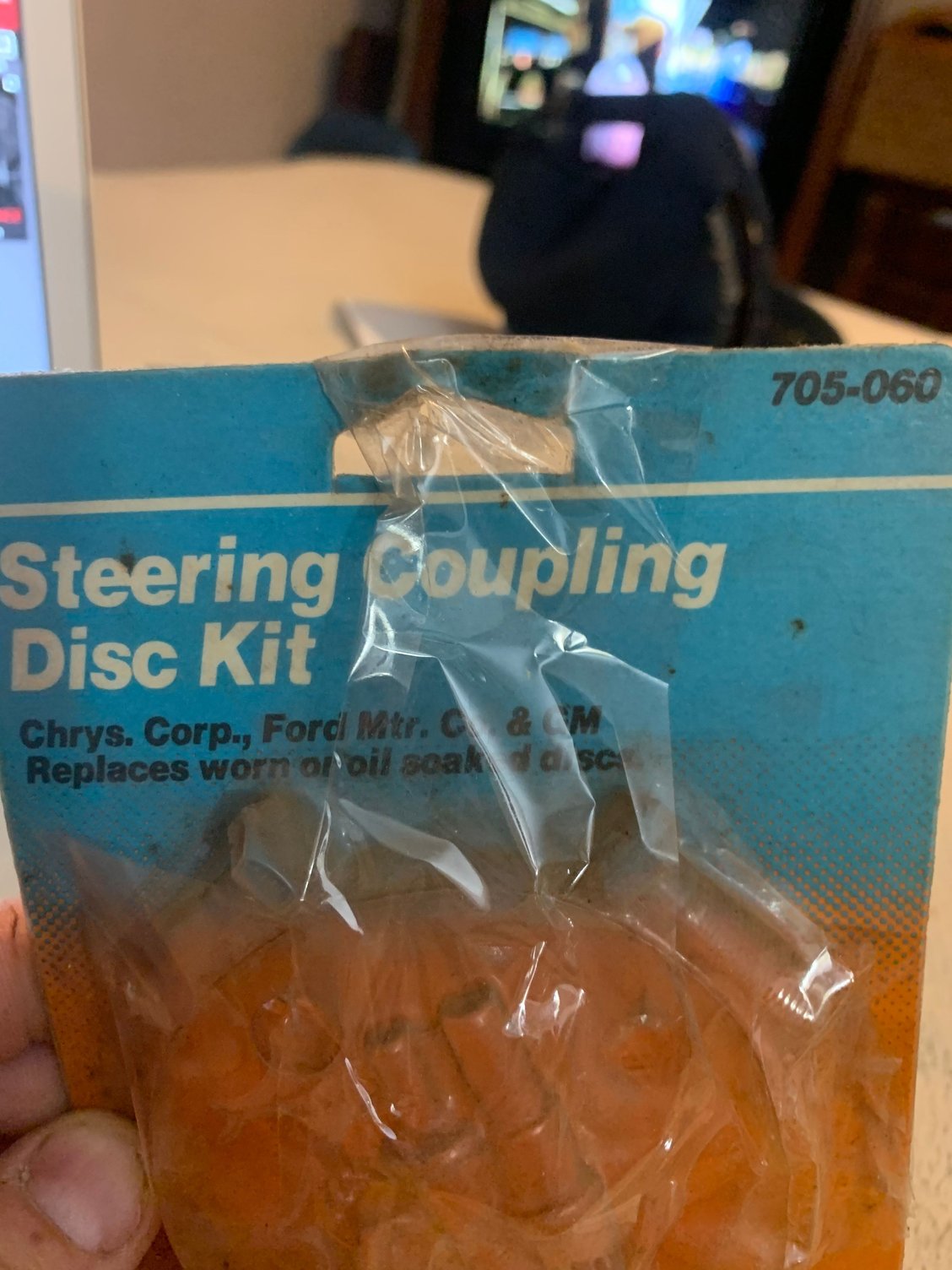

Here’s the kit you need and I located a few on eBay I just went through this with my car the kits they make now DO NOT FIT but this will
it’s made by doorman ... old stock
