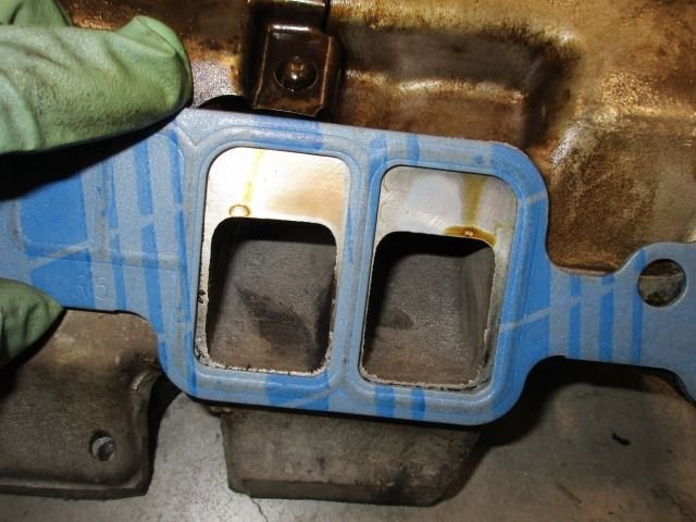

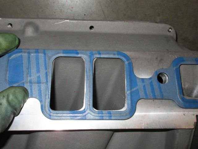

Installed a Renegade on my stock 82 with 115000 miles on it. Had upgraded to 85 fuel pump and Magnaflow mufflers on stock exhaust. Right away I noticed it would pull better to a higher rpm. Don't like really beating on the motor with this many miles on it but did make a difference. Here are some pics of the ports and how much bigger they are.
