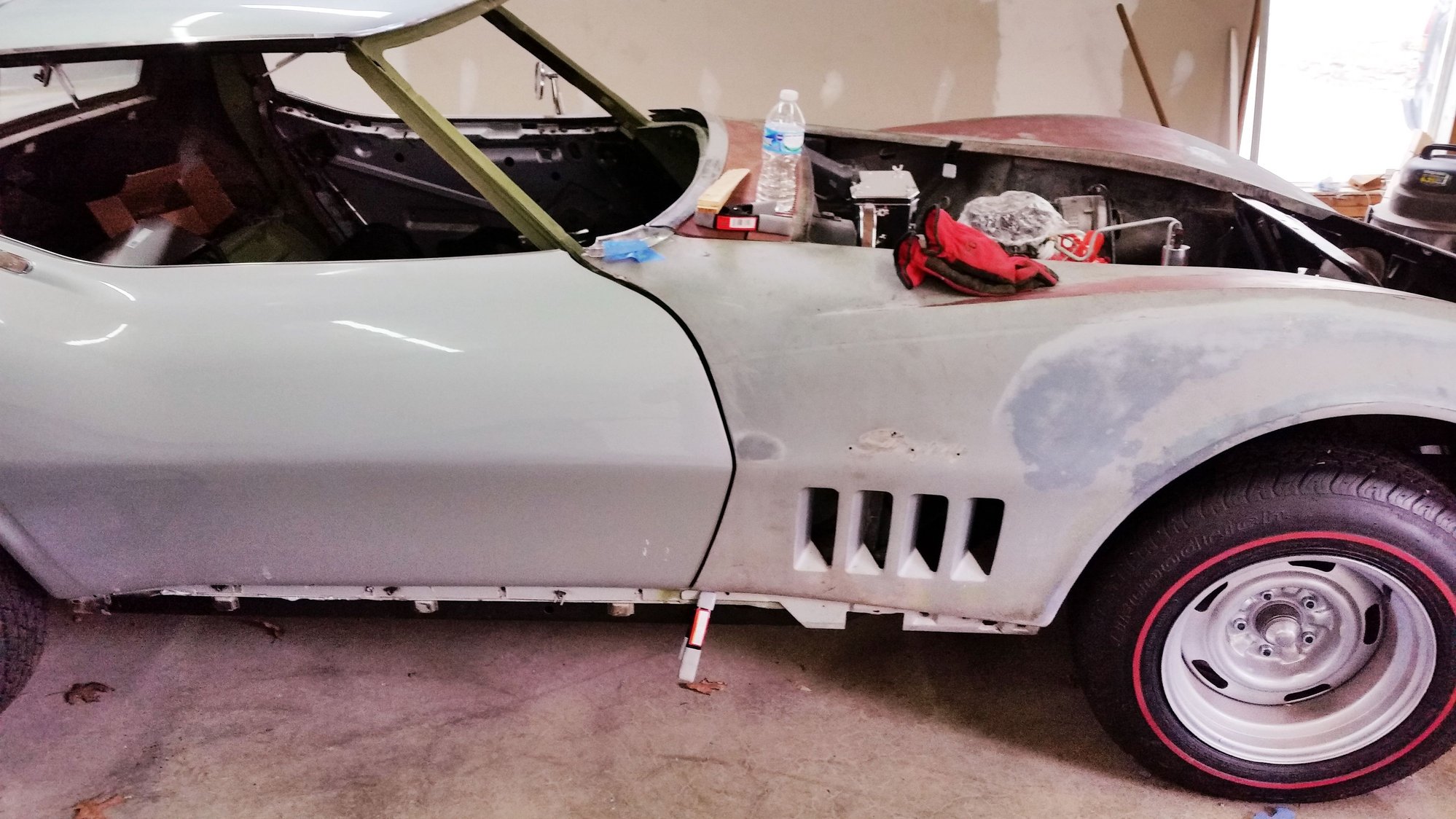

I have some experience with burnt cars.
I would pull the front clip, make body repairs, then reattach the front clip.
Removing the body leads to a full frame off restoration, and
you want the body on the frame to reattch the front clip.
It is the only way to ensure you have the front clip square before you glue everything together.
Before, requiring all fiberglass to be replaced.
After ....much better !

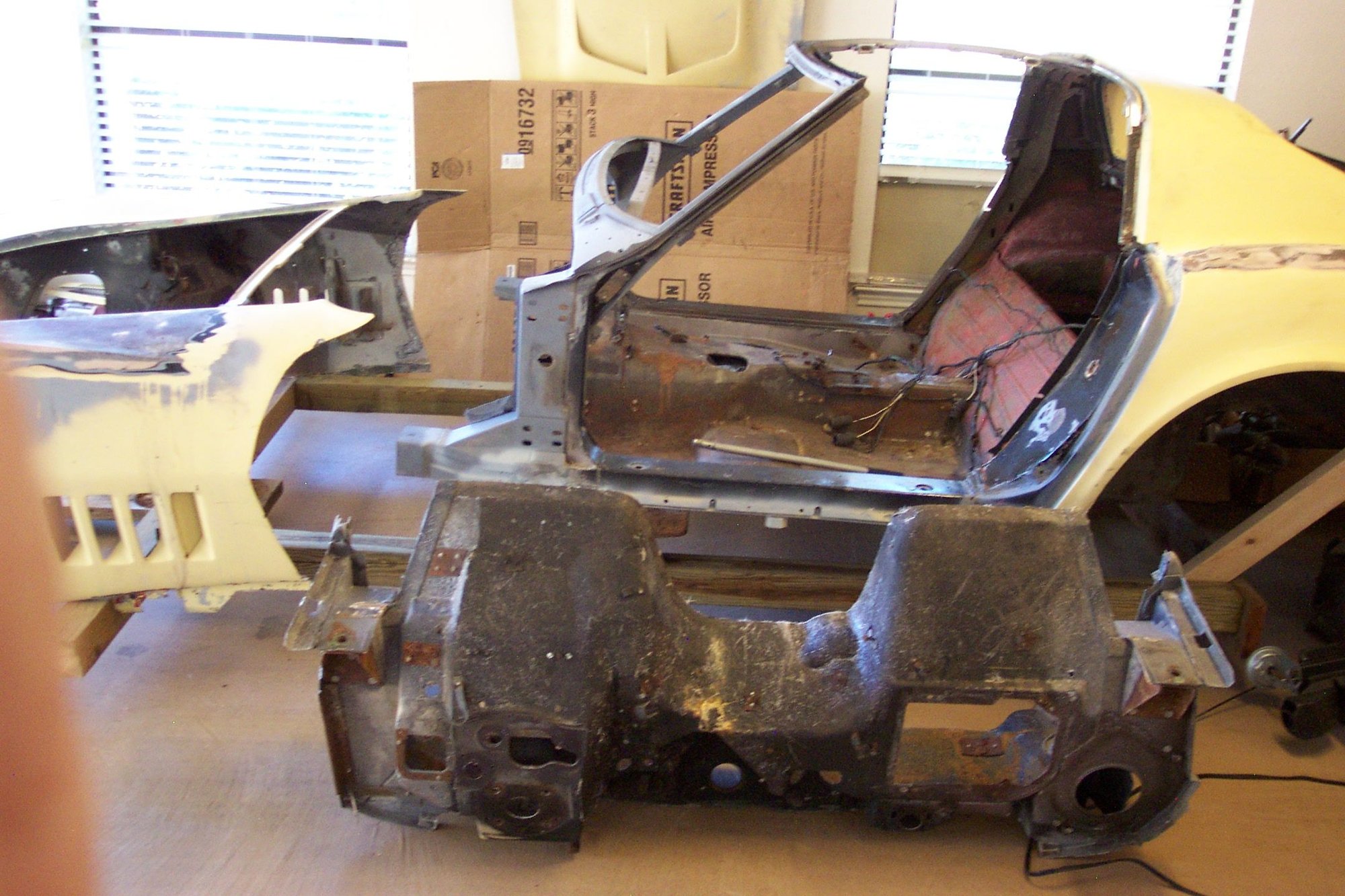

more pictures showing Firewall removal for reference, this is a major job,
if you require replacing the firewall.
Great pictures that really demonstrate just how involved a firewall repair can be. Of course it also demonstrates how much easier repairs to the forward part of the birdcage can be at that point as well... if needed.

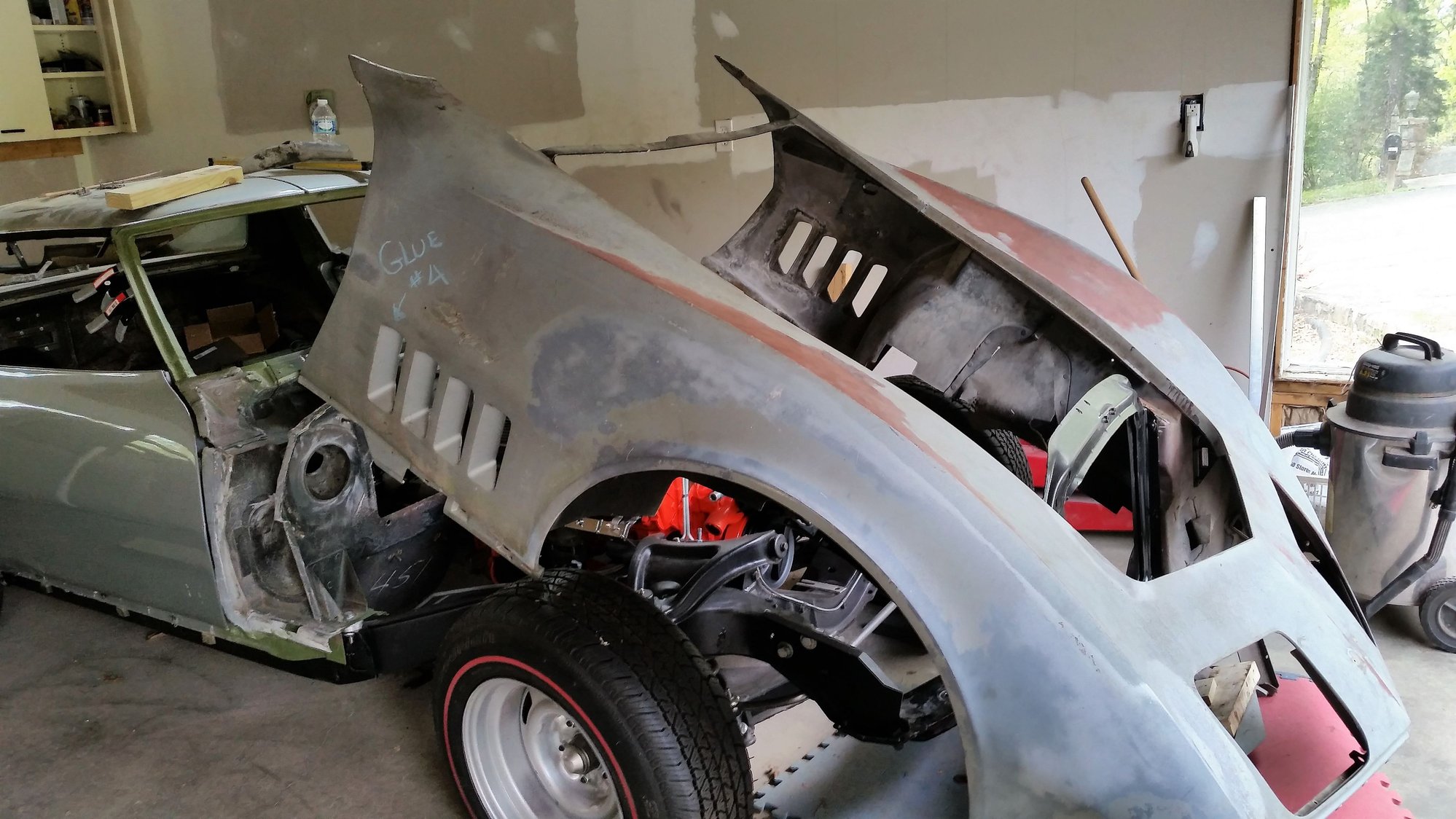

Originally Posted by rvzio
Many of us on the forum have done this work and it can be done. Many of us like me NEVER did any of this type work and the forum is here to help.
Your pictures give me "day-jah-voo" I bought a car with a broken front clip, had to remove it, and put another one on from another car. I fitted mine THREE times before I was satisfied, and finally put the glue on.
