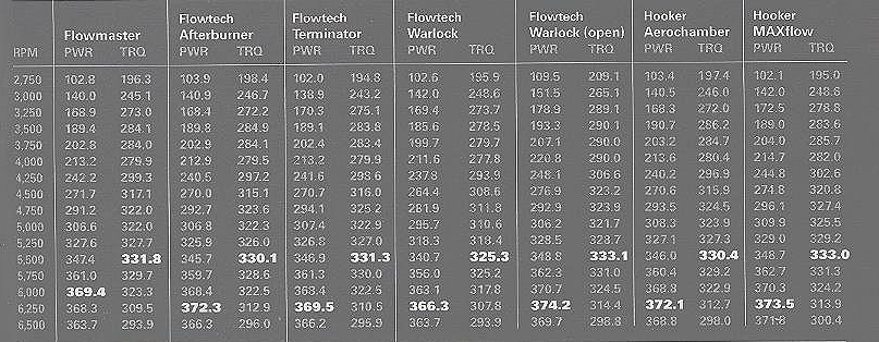

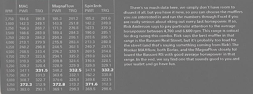

Had Flow Pros on my 82 383 motor for ages and replaced them just because they were old. Went with Hooker Max Flows, nice sound and they don't drone.
Here is something I found a long time ago to help with my choice.

been many yrs since I owned a C3 but those sound tone wise awfully similar to the stockers which I liked, only louder. Nice...kinda makes it sound more radical than what it is without being obnoxious
OP sound clips may or may not be accurate. If you try your regional section try and find some C3s to listen to in person even better
Know that compression cam profile can change the sound too. Dont worry about power just a sound you like not worth losing sleep over
