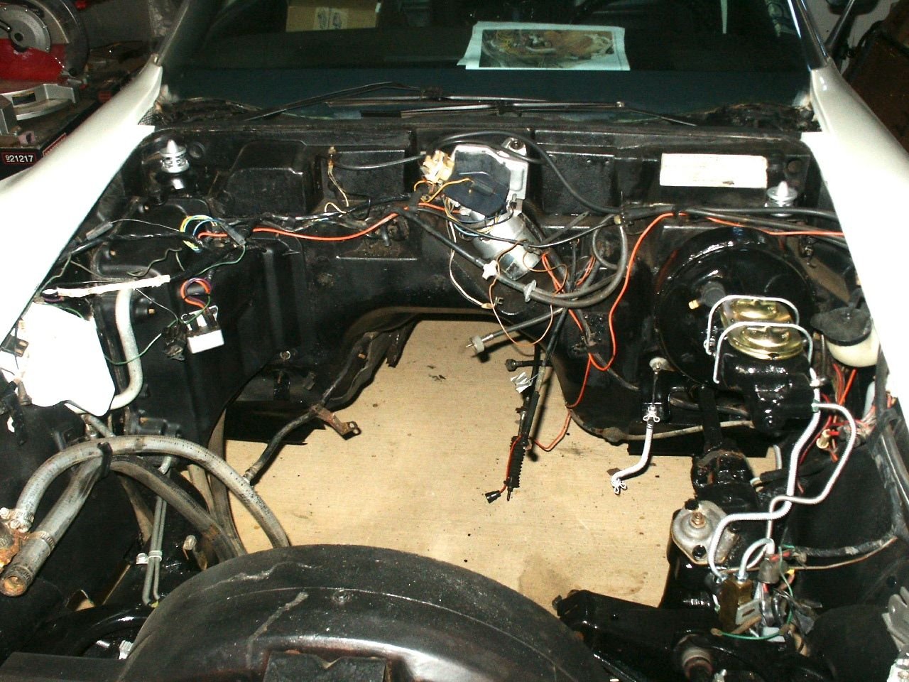

Just removed my 73 wiper motor assembly to give it a good cleaning. In the process I noticed one of the plastic fasteners(plugs?) was not fitting as flush as the other. I ve tried to get it to fit as flush as the other but it won't go in the hole all the way. Do these act as fasteners, or just a spacer? My wipers and washers have been working perfectly. Just wondering? Any thoughts or suggestions would be greatly appreciated before I reinstall. First pic, before Resto, showing missing plastic fastener.

Here is a pic of it actually on the car, before I removed it. So, as you can see the pin wasn't in all the way to begin with. Maybe I'm just worrying for nothing.
