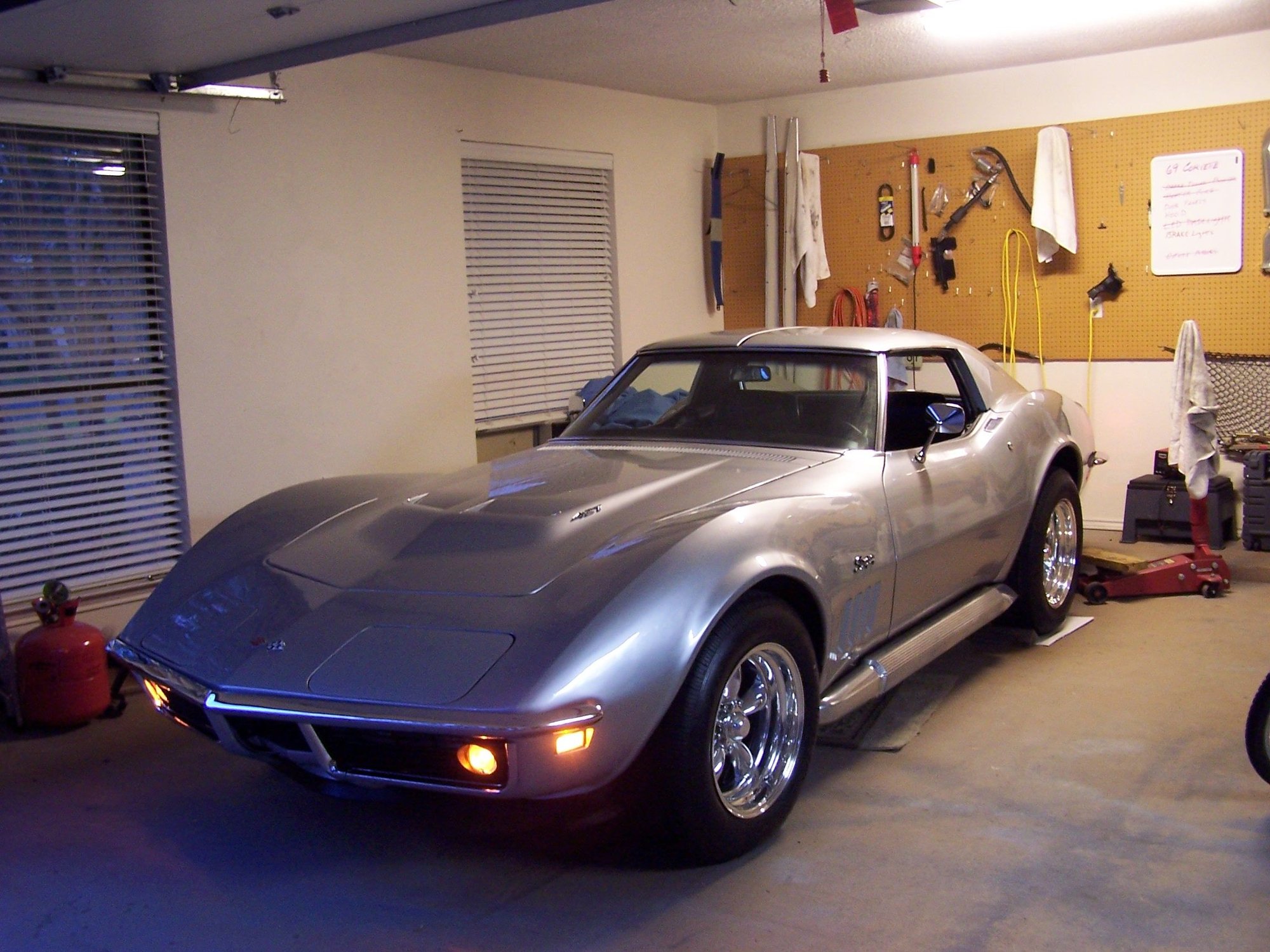

I also have used my parking lights as running lights, since the 1970's always,
I install the amber front turn/ lights, which are much more visible than white lights.
