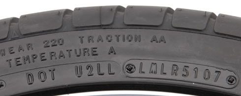

Having said that and considering the bulge you've observed, and the unknown age of the tires, I would suggest you first try to determine how old they are. Look for the stamped (molded) DOT number on the side wall (it may be on the inside of the tire) first and post it here.
http://www.tirerack.com/tires/tirete....jsp?techid=11
Just a hint, if the last digits are 4 numbers it is a post 2000 tire, three digits means it is a pre-2000 tire.
