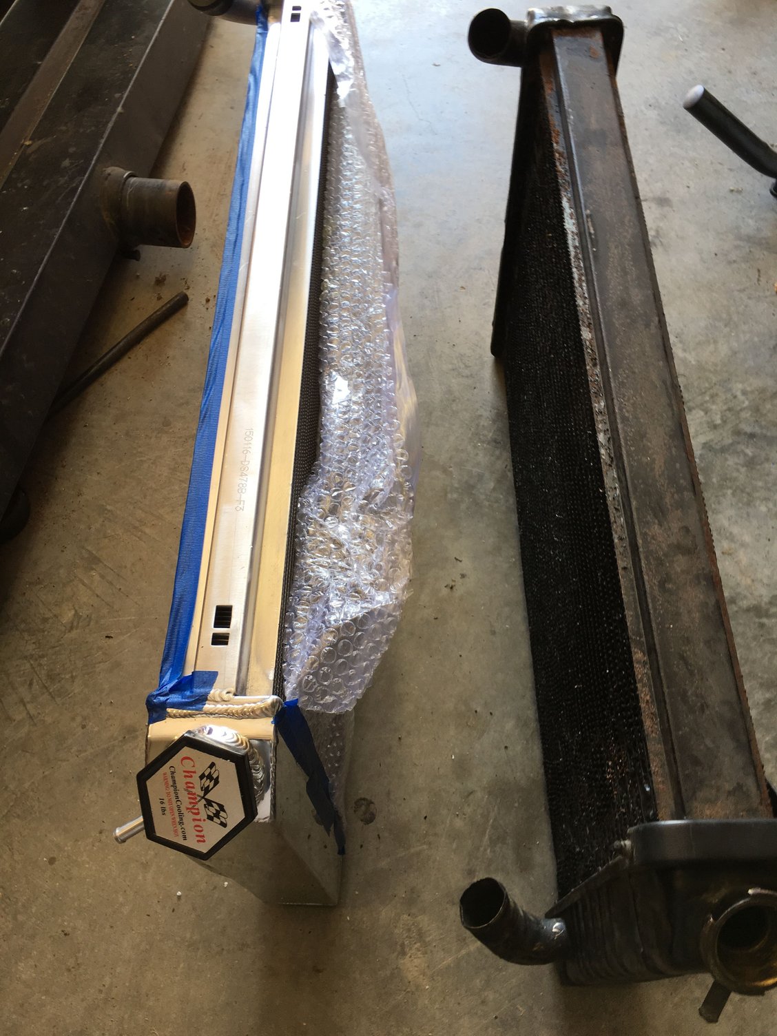

Originally Posted by croaker
Here they are side by side. Champion dropped right in . I will have to modify the brackets. I just bent them a little to pressure it up and test so far so good. It does have the relief for the hood. I ran the car for about 30 minutes in the shed was about 90 degrees today. Road test in a few days. It really wouldn't take that much for the manufacturer to to make it a drop in and go with the brackets
I've got a 3-row champion cooling a fairly large CI stroker - I agree the fit of the stock brackets is a problem, but considering the cost, I see it as a minor one. The champion should be recognized for what it is (at least in my experience): a very effective low-cost option. Other radiators may be 100% drop-in but you will pay more for that.
I've been running my champion for 2 years and it keeps a fairly strong motor cool in all temps - I have yet to get over 190 on a hot summer day (and with AC). I drive it a lot in the summer.
If I were more concerned with an original looks along with good cooling, I may have gone with a more costly radiator. I was only after functional, cost-effective cooling - I never pop my hood to show off, because I drive this thing and it gets dirty under the hood. I have not regretted it at all.

Champion Radiator in. 3 core . This temp was after 45 mile run 90 degree Louisiana heat and,5 minutes idling in driveway. No seals in .
