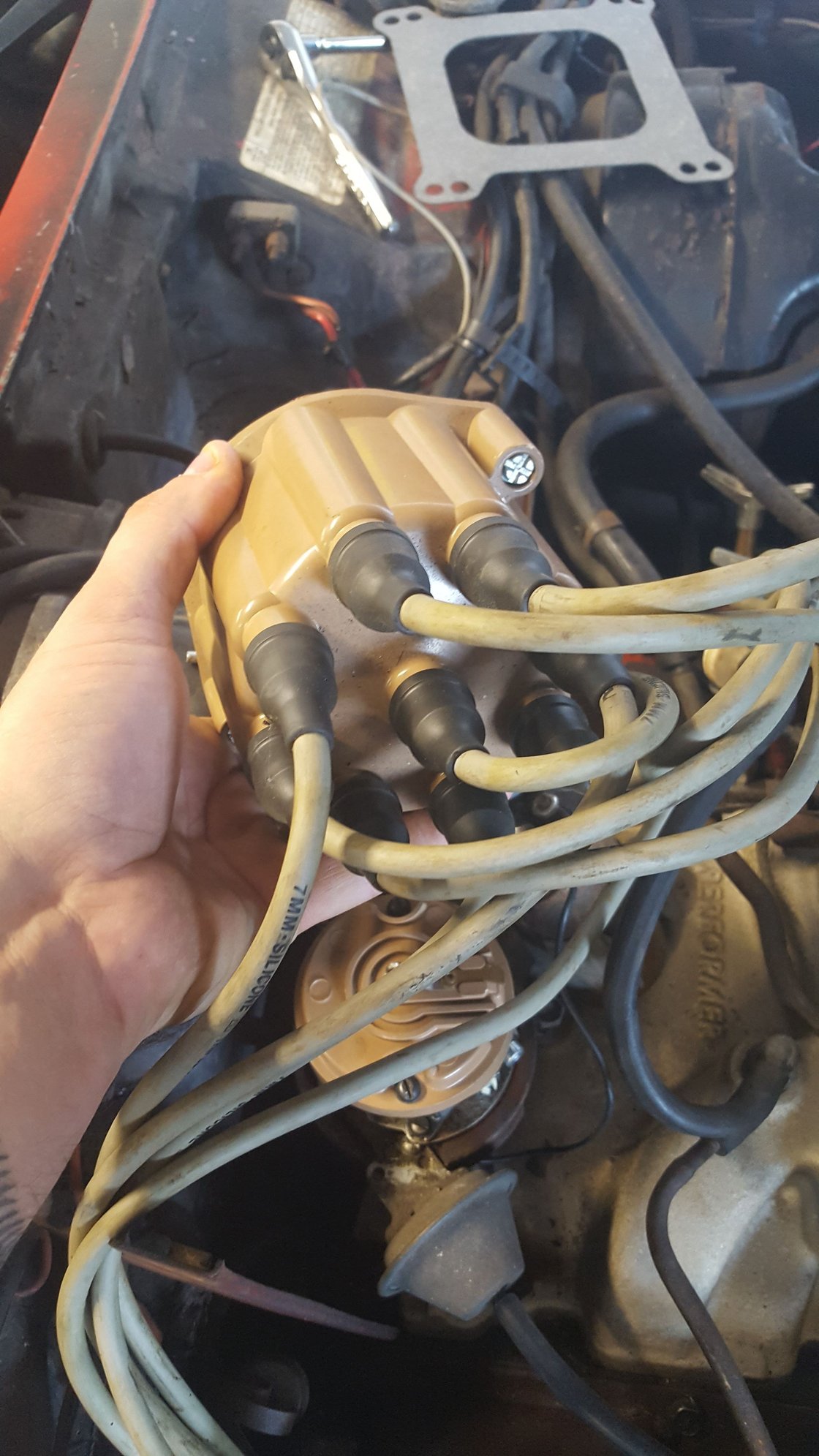

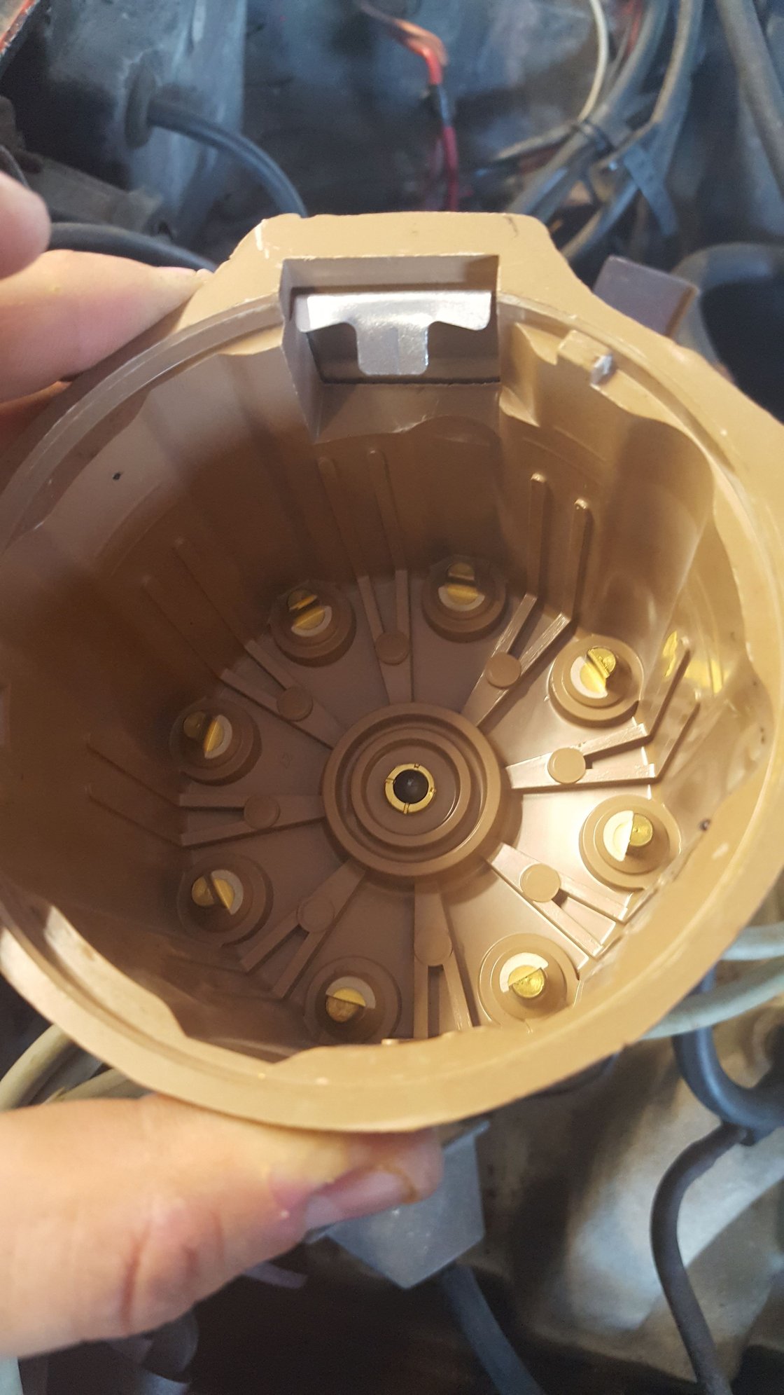

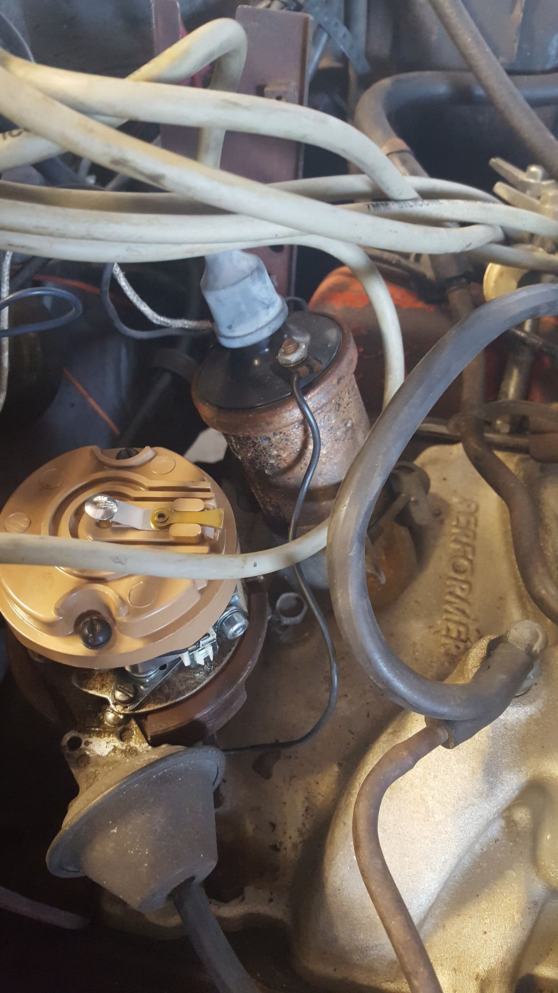

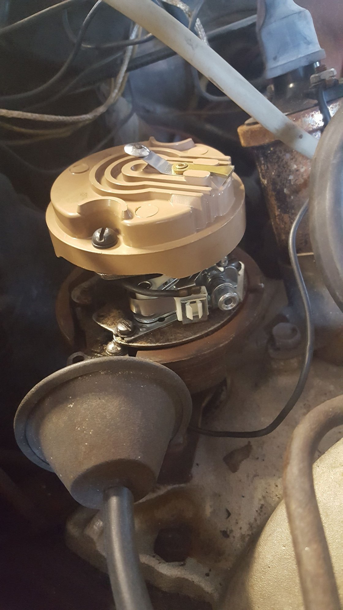

Here are the dist pics.

When I ran the same carb I hooked the dist up to the right port in your photo. The big center port for brake booster and the canister on the left port. I like full vac on the distributor. Start, run afew and stop sounds like a fuel bowl running dry. The new carb may fix that or you may have a plugged fuel line or bad pump. My car is a 75 sbc.
If the electrical is new, I wouldn't change it yet.
