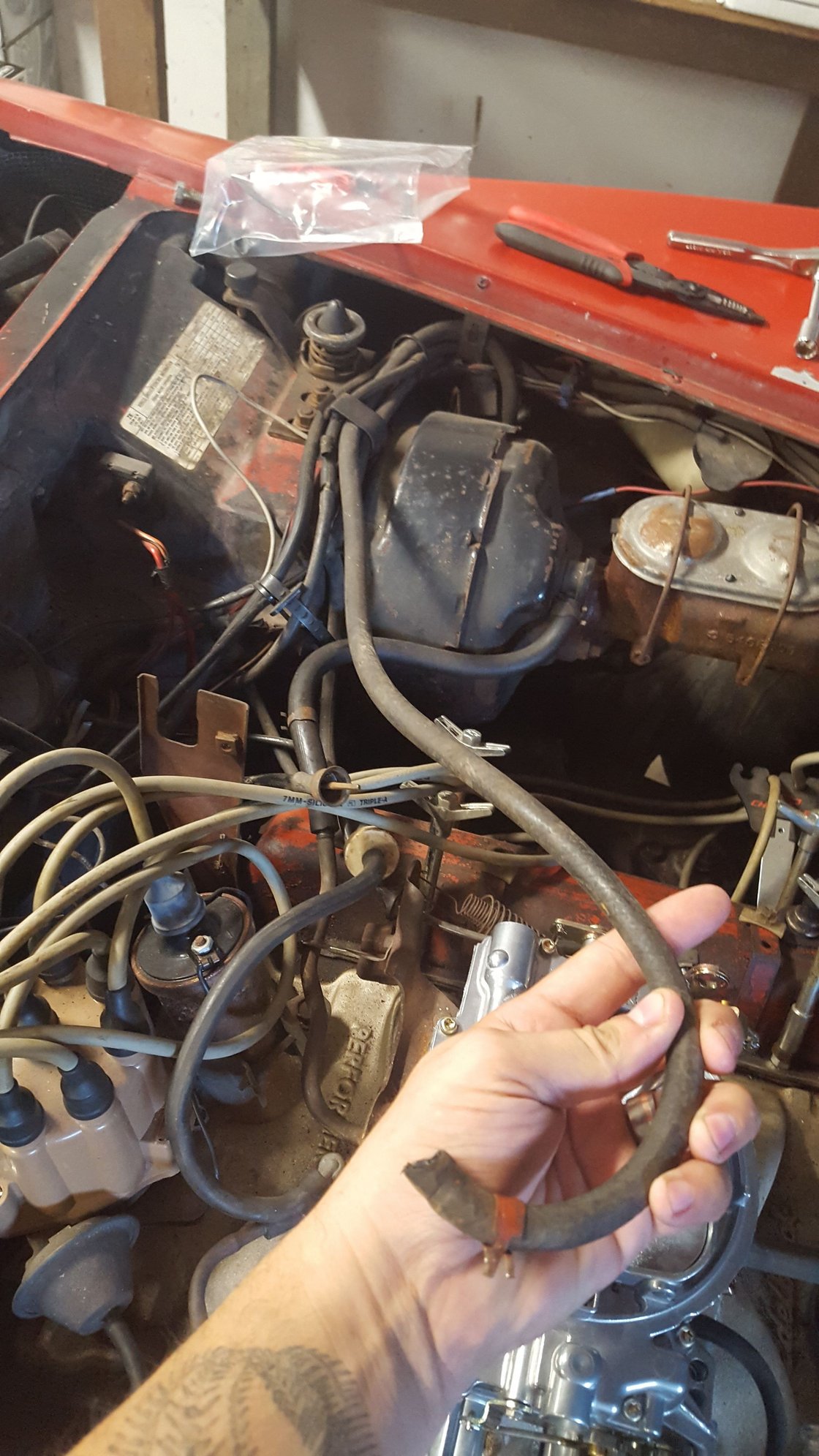

Well I ended up ordering a spreadbore to square bore adapter from Summit, and new upper and lower radiator hoses. They should be here on Wed. I do have some more questions. When I removed the old carb there is a hose that will not hook up to the new one. Any idea where it goes now and what it even goes to? It looks like it might go down near the bottom of the motor. I have not gotten under car to trace it but here are two pics of where it went on the old carb and the hose itself.

On my 77 that's vac for the canister ,it's below the wiper fluid can.You can get a flat plate adapter kit to go from spread bore to square bore at most auto parts places it'll come with a set of gaskets.Around here Advance and Auto Zone have a "Performance section" they will have the carb stud kit as well.
So where should I put it on the new carb? The carb did come with a 3 port T type fitting, but it looks like its an 1/8" barbed fitting. This hose appears to be 1/4." Do I need it or can I cap it off?

The canister is for collecting fuel vapers from the gas tank and sending them back to the carb to get burned,mine is on a port vac line from the carb ,if you don't hook that back up you may get a fuel smell when parked.On the instructions that came with the carb it should tell you what ports are port or manifold vac.
