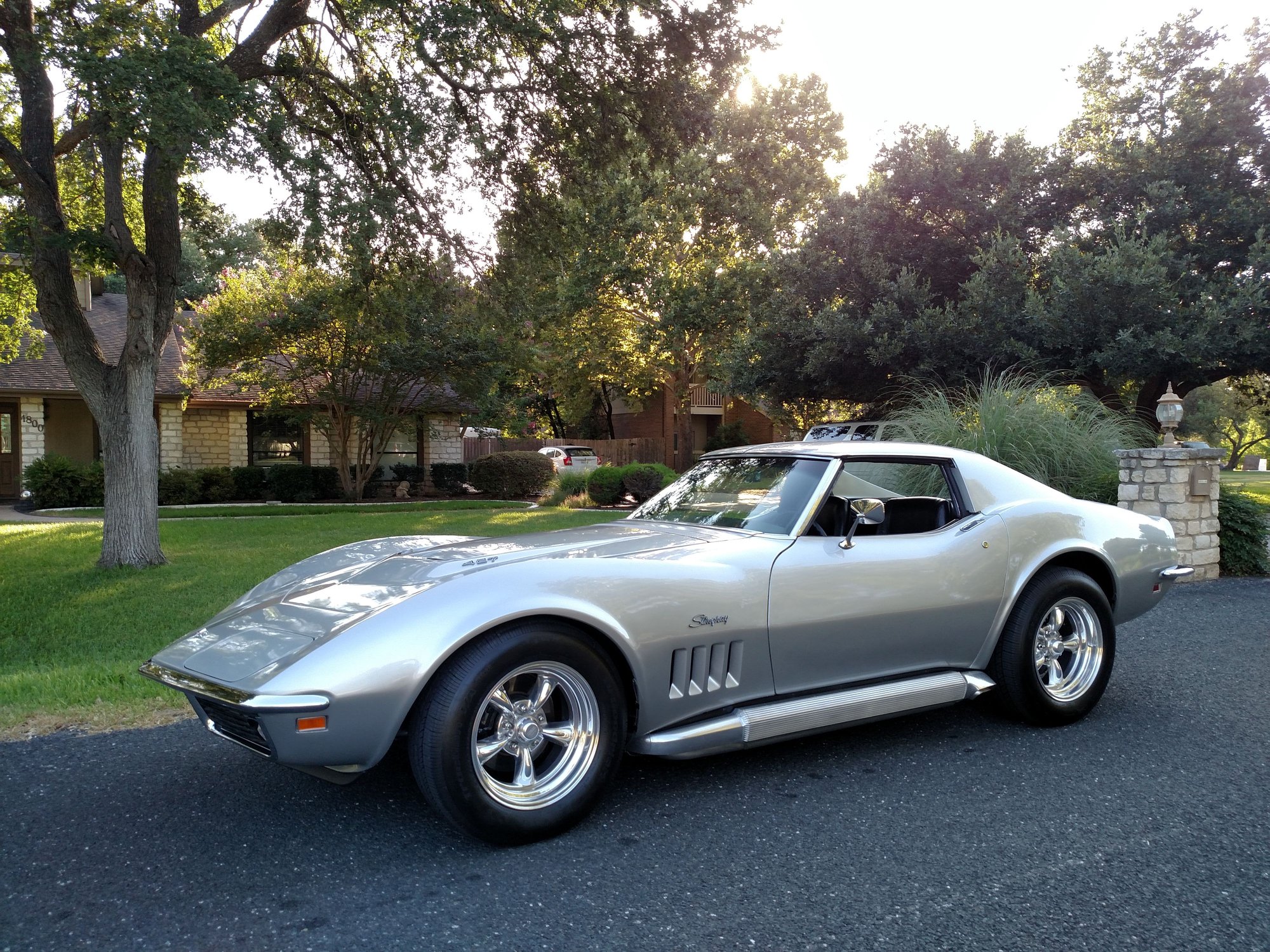

food for thought, ... I converted to a BB from SB left original springs,
me personally I like it squatted down slightly in the front.
this is the stance from SB to BB with ordinal springs.

The front looks good but in my opinion the rear needs to be a little lower.

When there are 2 people in the car the rear sits lower. I also have the stock AC small block springs in my BB AC car. It sits fine, and the rear is level with two people in the car.
