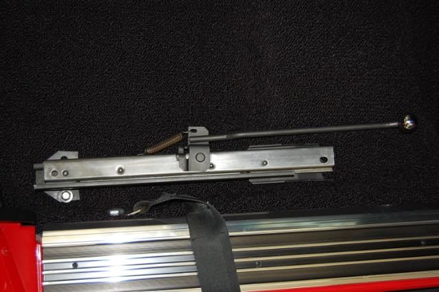

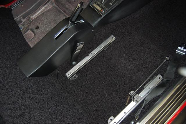

A right side outer seat track showing the bolt going through the carpet in the rear and the front bolt covered by the carpet flap. The seat adjuster is operated with the RIGHT hand on both seats.
The front flap lifted showing the front bolt.
Both tracks install in the same way.
Julian date on a track. 301st day of 1970.

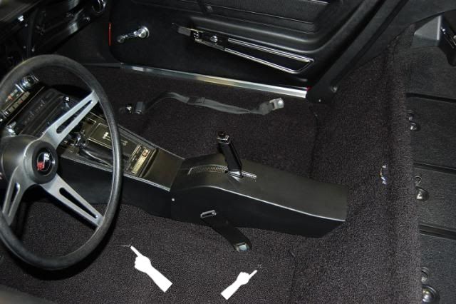

Here the carpet is ready for the seat to be installed… flap to cover the front bolt and hole punched through carpet for the rear bolt.
