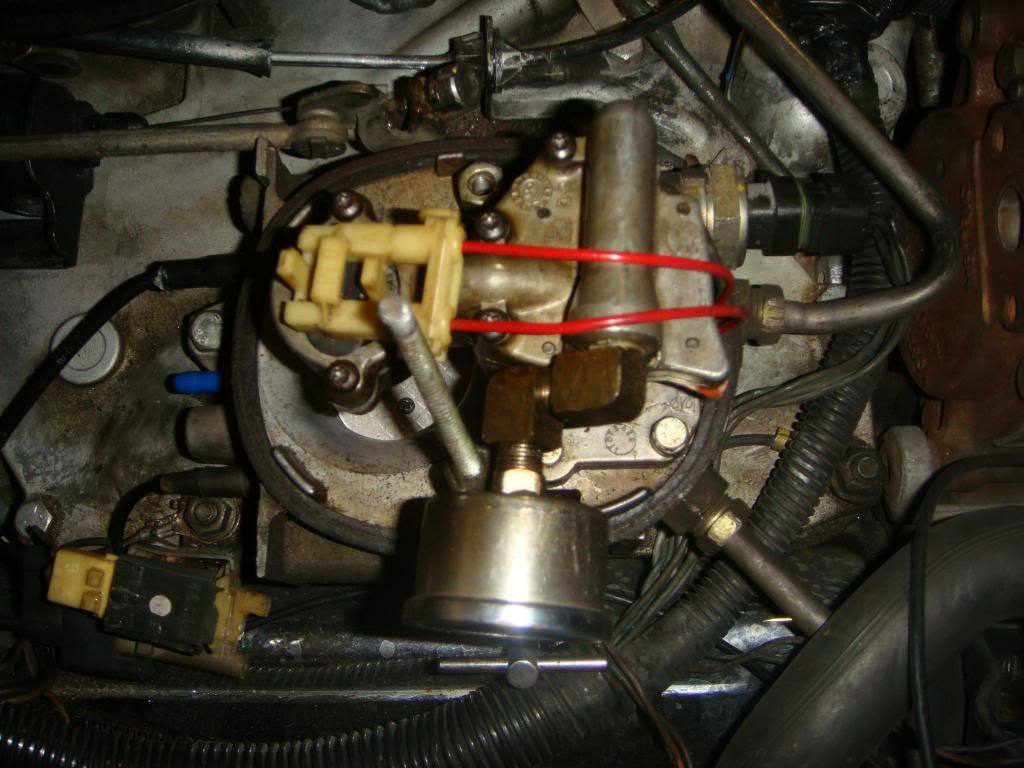

Here is what I did.

Terry, Larry and Dub thanks for the input. Terry & Dub you make good points. Dub sort of nailed what I was picturing in my head with the stainless braided line and AN fittings. I'm liking Larry's idea too. Looks simple and it must work or you wouldn't use it.
