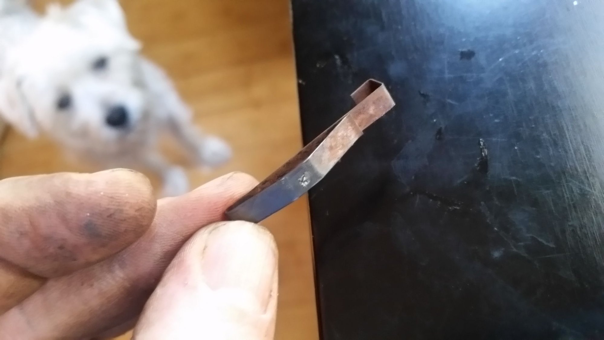

I'm replacing turn signal switch/canceling cam on 1974 small block coupe, automatic trans. The column is on the bench (I seriouly don't know how this can be done with column in car, but thats a topic for another thread.)
Can anyone tell me where this part goes? (Not the dog, I know he goes outside. He photobombed this pic.) It fell out of column when I pulled signal switch and wires out. Do i need thjs part / is it functional?
Part from steering column, 1974 corvette.

That is the contact for the key buzzer.
http://www.parts123.com/corvettecent...size=50&page=1
It is the clip that holds the key buzzer switch in place. The following pic shows a standard (none adjustable) column with the switch and clip. If you have a T&T column the switch and clip may be a bit different. But you should get the basic concept from this pic.
Jim

I stand corrected Jim. I really like to see your detailed posts and pics. Thanks for the information.
