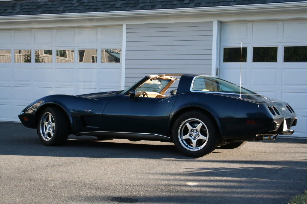

Yes, I have heard of this front inner fender shaving issue for years on 78 corvettes but my early 78 L-82 4 speed Gymkhana suspension(build date Oct 77) does NOT have any fenders shaved front or rear from the factory and my 255/60/15's never rubbed all these years. Below is the 78 with Front 255/45/17 ZR tires and rear 255/50/17 ZR tires...Staggered tire sizes are very common on modern sports cars and gives the car a much better stance (versus the common rear end motorboat look of some year C3's), IMO, but I also did 255/50/17's in the rear since I did not want a smaller diameter tire than the 255/60/15's with the 4 speed and 3.70 gears...it turned out to be a win/ win

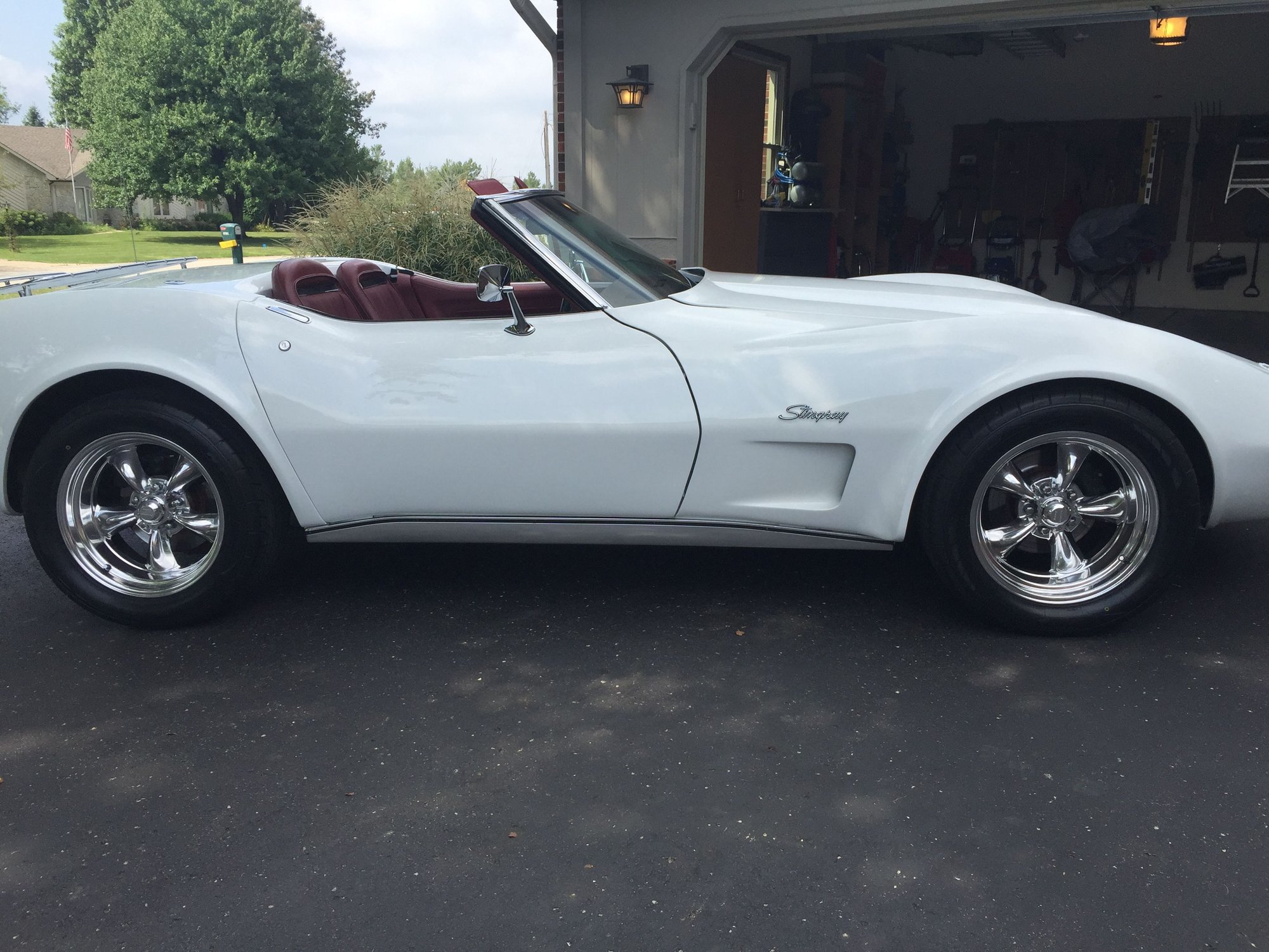

The picture is an example of a look lowered approximately 2" all around and riding on 255/50/17.
