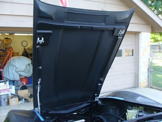

I used the brush on POR-15 paint for the frame. Man that is some tough stuff.
I used the John Deere Blitz black for the semi-flat areas.'
Here is a picture of the underside of my hood sprayed with the John Deere paint...
