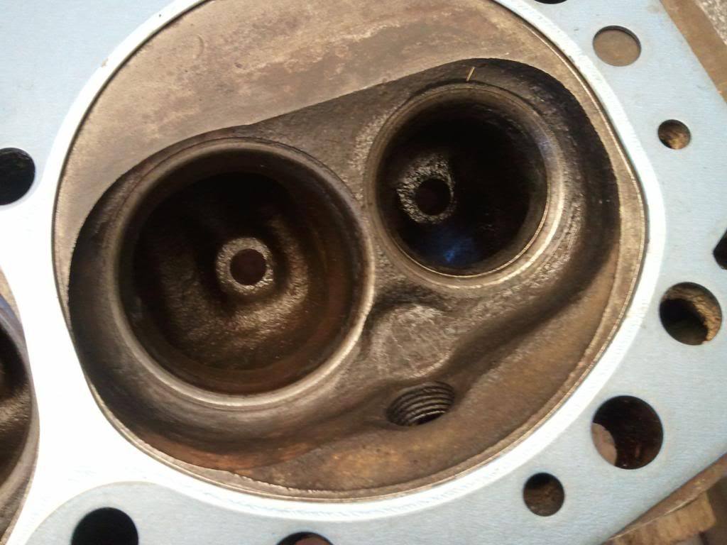

Below is a set of 69 186 heads from my extra L46 engine, the engine cam from a 69 convertible with 65k miles on it.
I did grind the valves with my valve grinding machine, but I had to grind much, so they are close to be scraped, I didn't because the engine will never come into a car again.
After a bit of work, but still not finish.
