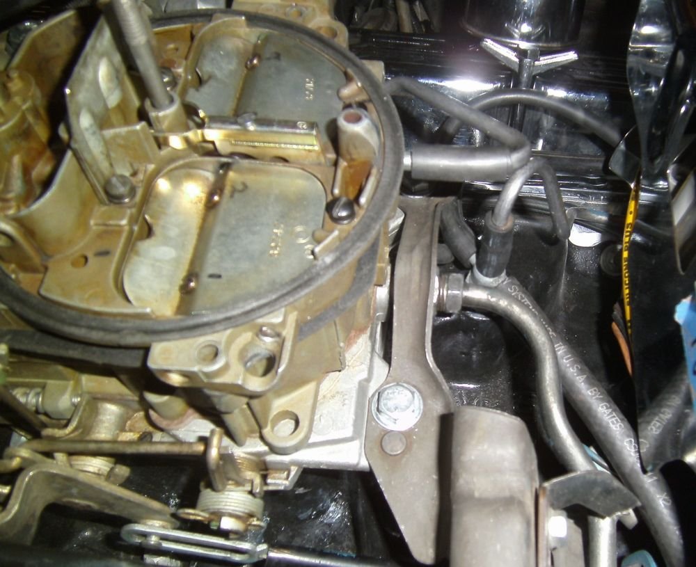

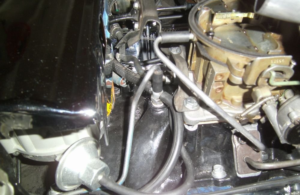

Here is a couple of pics from my 77 if this will help. The curved pipe on top with a short rubber piece is for the vacuum modulator.

yes, that is the correct hook-up even in my 76. do you have the pipe going down to the traaansmission?? snd you do know how to adjust the new modulator to shift correctly???
