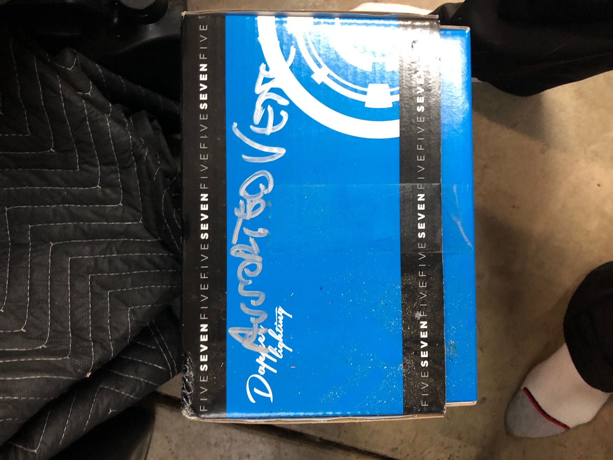

Went with a company called Dapper Lighting a little over a year ago. Kind of spendy but plug and play with optional angel eyes. No mods were required. I have no affiliation with them but I’ve been pleased with their performance and they look really cool.
