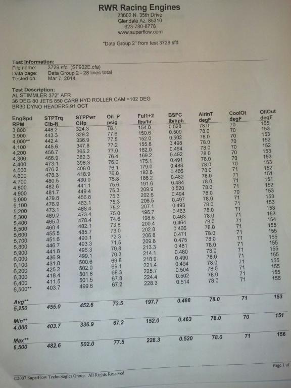

Below are 2 sheets. One is a 406 with 210 Profilers. The other is a 406 with older AFR190's. Both have very mild camshaft profiles in the 230 range. With a camshaft in the 240 range the power would be there.
Jeese I leave it alone for while and finally some kind of sense is made.

Here is a 372CID......4.125 x 3.48 x 6" rod. To me for a C3 application this combo makes sense.

I'm impressed with the Dyno sheets provided, they show some decent numbers from 372-406ci. What is common to NASCAR and NHRA ProStock is the necessity to find even 1/2hp beyond what the other guy has. I believe (imo) that most of what we have available today in terms of Cylinder Heads and Intakes are a direct result of those two Race games. I recall Head work being super secret in ProStock back in the 80's, now you can get heads mailed to you that'll outperform late 70's/early 80's PS Heads.

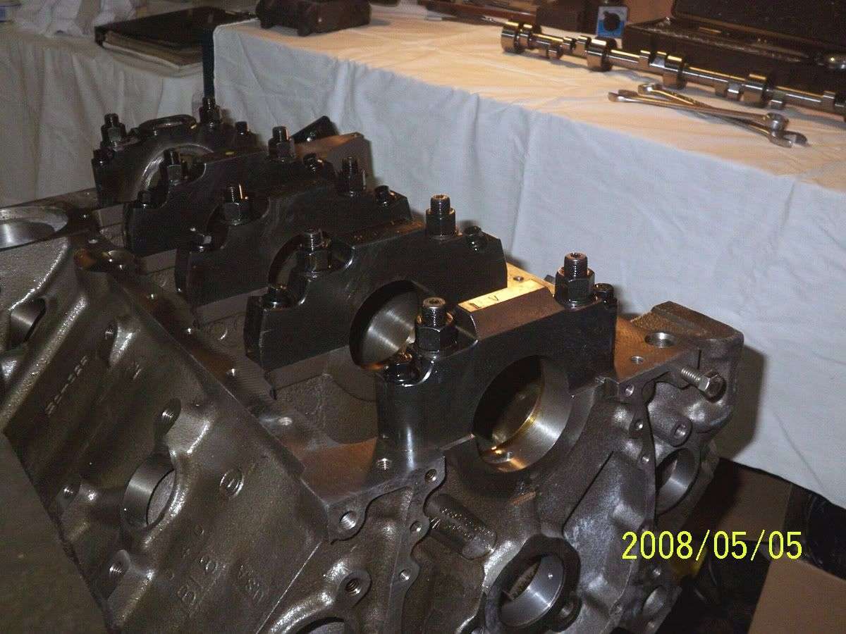

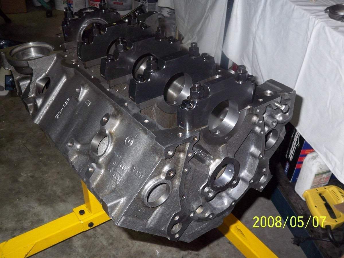

Sure how bout all 5 four bolt billet steel caps, with the middle three splayed ,got them in my Motown 427ci

I believe I am the one posting dyno sheets. My customers have posted dyno sheets. I might be "typing" on the point but I am also bringing along hard data.
Could you please post some hard data on your findings?

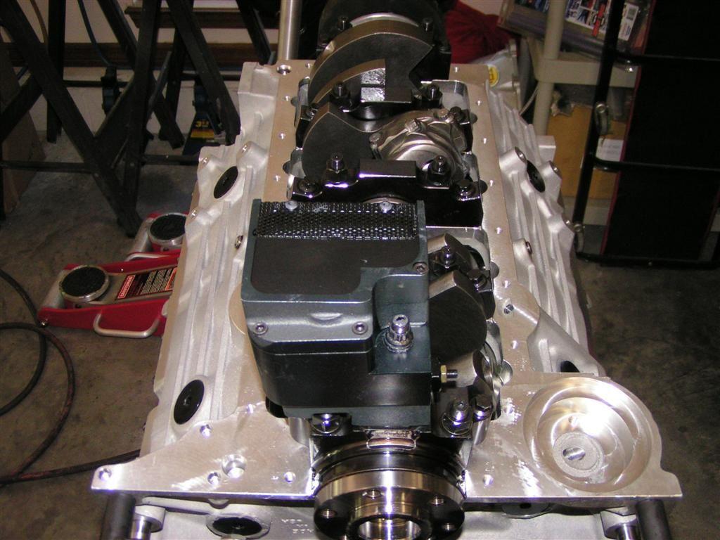

Sweet bottom end (the motor, not you!), you're ready for the true torture test. Put that sucker in a Fountain and then one or two more like it, turbo/intercooler adds and pound some water into submission
Old Nov 4, 2016 | 09:43 PM
  #39
jimvette999's Avatar
jimvette999
Joined: May 2002
Posts: 2,431
Likes: 52
From: Florida
Same here on my Motown 406 build

Holy shnit is that an aluminum block ?
