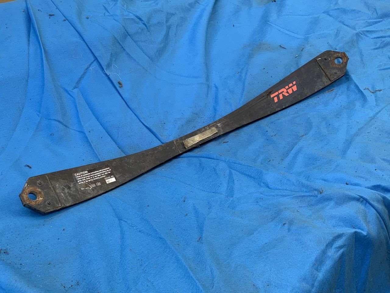

My TRW 355# spring

Originally Posted by Dodosmike
My TRW 355# spring
Thanks, that is exactly what I needed!

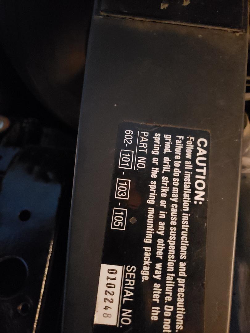

I have a TRW composite leaf spring that I want to sell, but, the readable part# is incomplete. "602 ??? 103 105" "s/n 0104457". From the comments it appears the second # group is the spring rate. So, am I screwed ? Hope the pic helps.

(another old thread back)
The second group is the spring rate
101 = 315lb
103 = 340lb
105 = 355lb
First number would have been the 602
Since the 103 and 105 are still visible and not punched I'd say it must be a 101 so 315lb. Only other thing would be the width in the mount area and I'm not sure if they were actually different or they just used different plates. Do you have the mounting blocks etc that went with the spring?

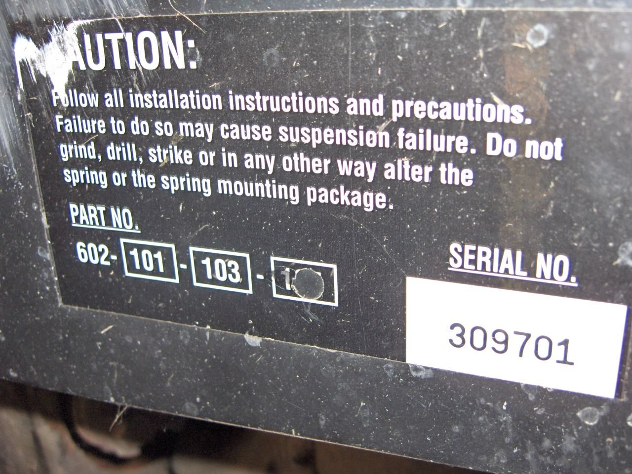

Just wanted to add, that sometimes they missed with the hole punch, notice the hole above 105.
