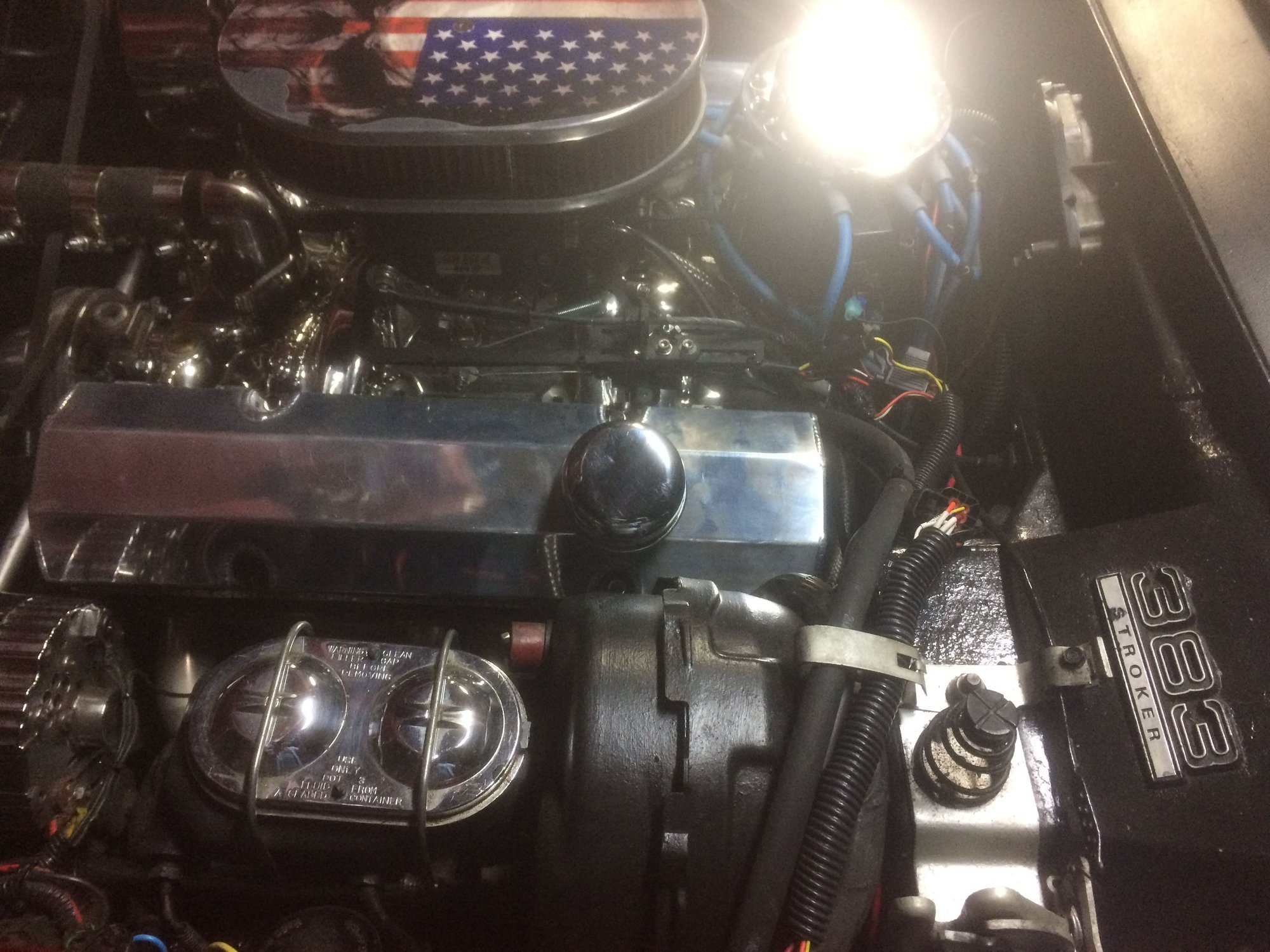

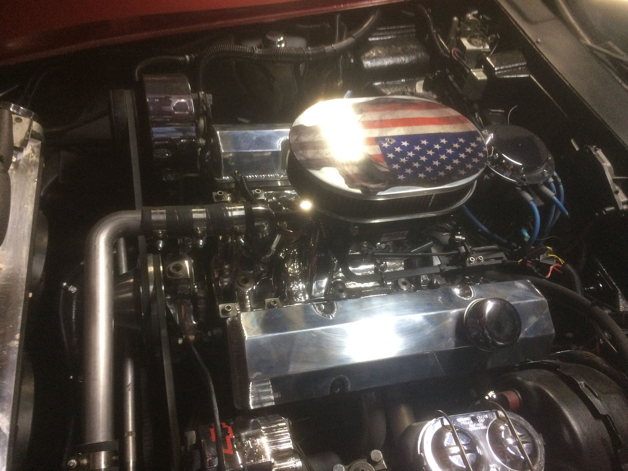

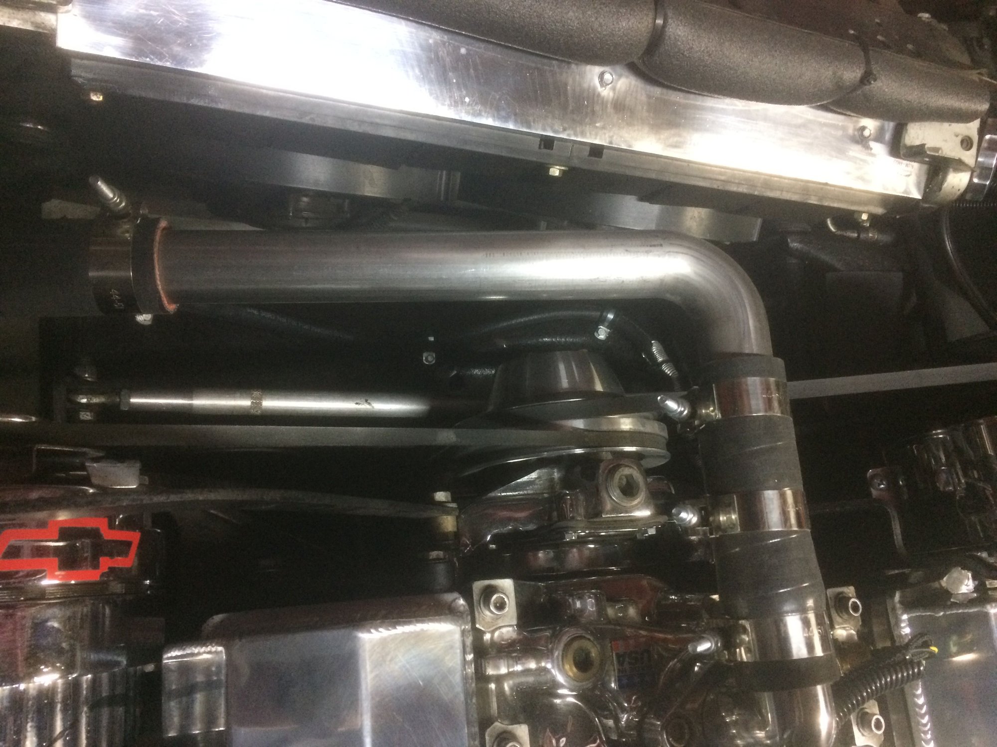

Can you describe or post a picture of how you routed the lines from the FCC to the throttle body? Curious about how people approached fuel line routing in case I ever go this route.

If you mount the FCC in the vapor can location its really easy. I just routed it up over the brakebooster into right into the throttle body. Really clean looking.
The line from the mechcanical to the FCC could be a bigger issue. I run a electric fan so mounting line right to the frame in front of engine was easy.
I have not purchased the system yet. I have really been researching as much as possible to avoid any pitfalls when the time comes. I am currently running a Summit 600 square bore,vacuum sec. and electric choke. With a 1" spacer on a Weiand Action+ and it really has done a super job. With very little tuning it run great out of the box. I have been concerned about plumbing the vapor vent from the FCC, which fitech says must be returned to the tank. Thankfully, Bloodzone clarified what I thought about "T"ing into the existing vapor to tank return. As I have discovered, the '79 did not have check valves or a vapor/fuel separator. I'm not 100% sure where to locate the FCC yet because of being focused on the vapor return. I'll post updates,thanks.
Great pictures, Bloodzone. As if I needed more ideas what I can do under the hood. I am running a electric fan also, and I thought that would be the practical way to run the line to the FCC from the mechanical pump. Also looks like I found where to put the FCC also. I really can say that is by far the sharpest underhood I have seen. I can really appreciate what you have done. WOW! Do you have a quarter mile run on it? Thanks again for the pictures. And advice. And ideas for projects!
I'm a little slow on the typing but I'll get there eventually!
