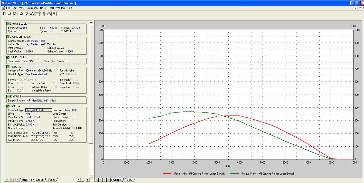

I have Dyno2000 to model this on. I show a stock L48 with these additions generating 424HP at 6000 RPM. With a high performance exhaust you're looking at 350 ish HP at 6000 rpm.
Yep and that cam is a HUGE limitation on those heads.
0.465 lift and those heads have a pretty rapid rise in air flow until 0.550" of lift. So if you can't go with a bigger lift cam definitely go with 1.6 rockers to get more lift.
I haven't found a better way to bolt-on 400+hp for less money.
(Pull the cam stats for something like a Voodoo 268 Advertised and put that in to DD2000 and then do it again with 1.6 rockers and repost the HP -I'm guessing you'll get another 40-50hp.

Wow good estimating! I show this cam: http://www.lunatipower.com/Product.aspx?id=2325
Generating 460HP at 6000RPM. With the hp exhaust it goes down to 372HP at 5500rpm.

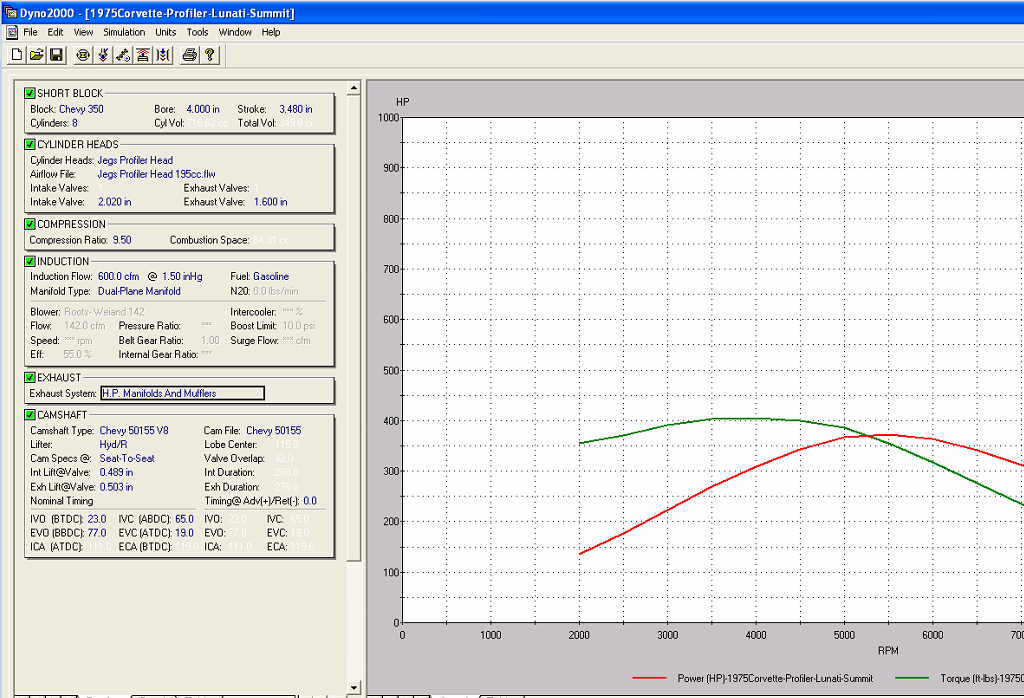

Generating 460HP at 6000RPM....
You never look smarter than on your resume, and your engine never looks more impressive than when you model it in Desktop Dyno 2000...
Those are some highly optimistic #'s for a 40 year old L48 with heads, a cam swap, and new exhaust. (I've heard the torque #'s in DD2000 are more optimistic than even the HP #'s, too.)
Now change the intake valve lift manually to 0.522 and the exhaust valve lift to 0.538" -to simulate 1.6 rocker ratio. -I think you accidentally pasted the image for the stock cam again... (Maybe not; you're valve lift #'s are right... -maybe you just overwrote your previous cam file by not changing the filename?)
Adam
That comes to 465hp with open headers.
Yeah I just changed the numbers but didn't change the name of the cam. I'm imputing the cam data manually from a file I have of cams.
Also agree that this is HIGHLY optimistic results. Figure it's 20% off at least from real world. I'm assuming that if I did this to my tire old L48 I'd blow the crank out of the bottom. Then I'd get to get a new engine!
