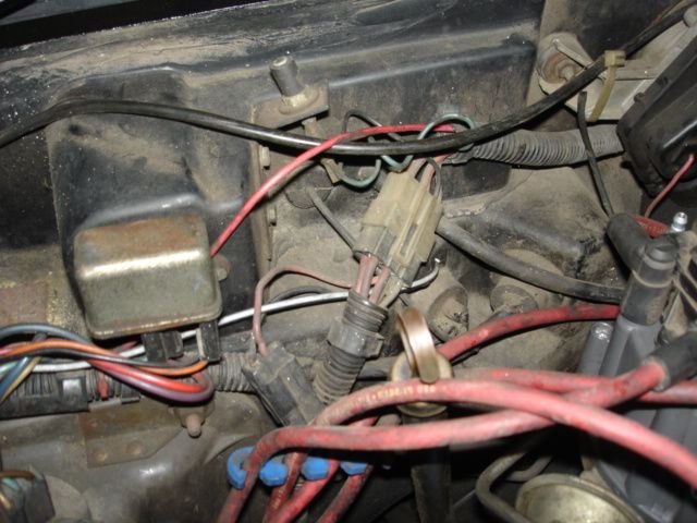

I know you know about this connector I previously mentioned...but I thought I would post photos of if so if other members not aware of what it looks like...they now have a reference.
DUB

I was using simply a test light to test for draws. The yellow wire made the courtesy lights go ape crap. They pulsated on and off until the timer kicked them off. The test light pulsated with the flashing of the courtesy lights.
It was quite freaky. The damn car has a ghost.
