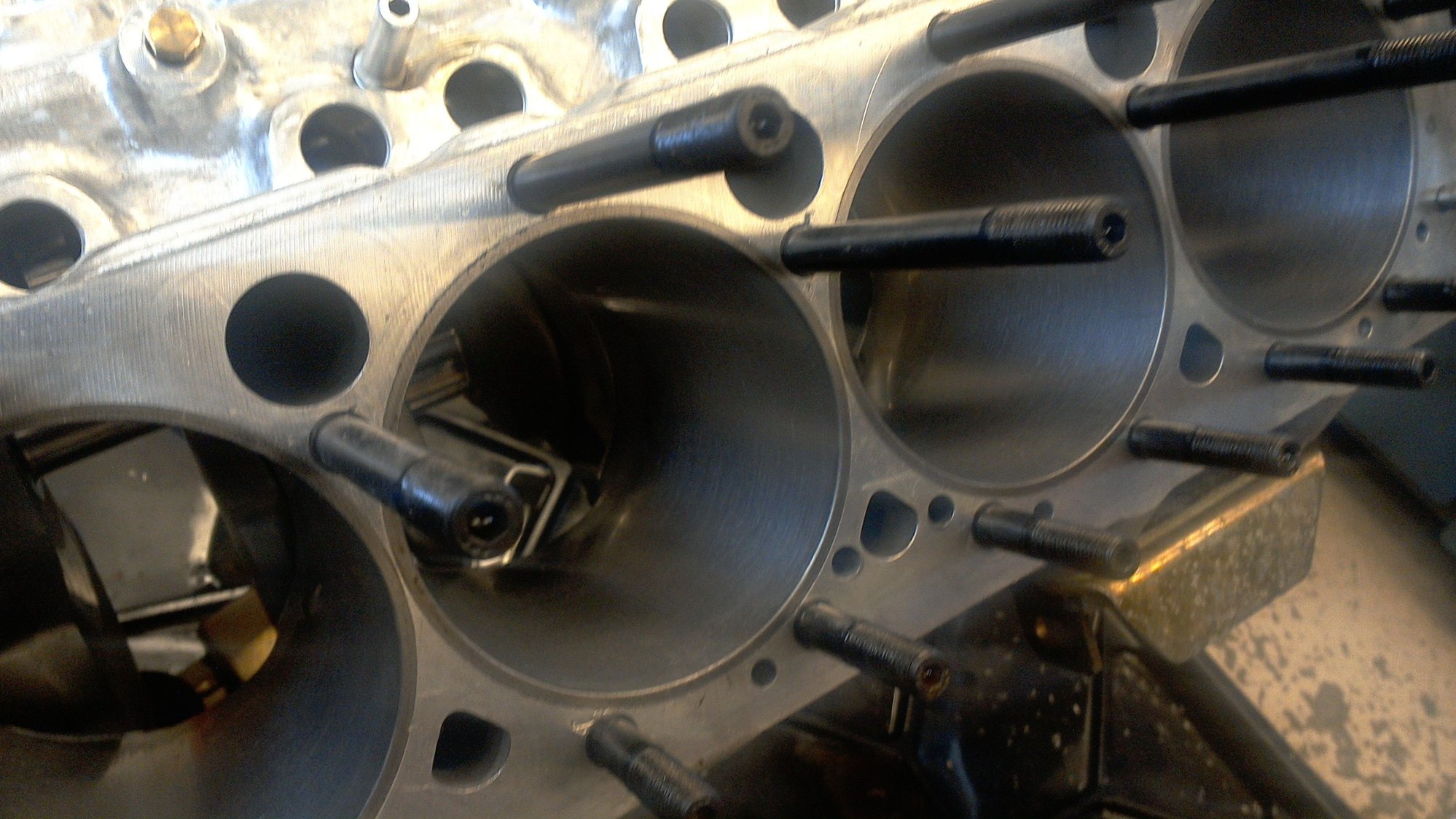

I have been chasing an Oil burning issue for a long time and finally had to bite the bullet and disassemble and re Ring. Really have no idea why the Oil Rings were blowing by I think it might of been a combination of running way to Rich on initial start up and running to much oil in the Pan ever since. One way or another after 1000 miles the Pistons still didn't have any carbon build up on them due to a good coating of Oil. The Machinist who did the original work had retired and took home his best tools and continued to work as a hobby. He would only work when the Temps and Humidity were right and the Parts needed to sit in his shop for 10 days to season before he would touch them. I'm not going to let Him know that I took a Ball Hone and knocked the Glaze off the Bores this time around.
Fresh from the Ball Hone

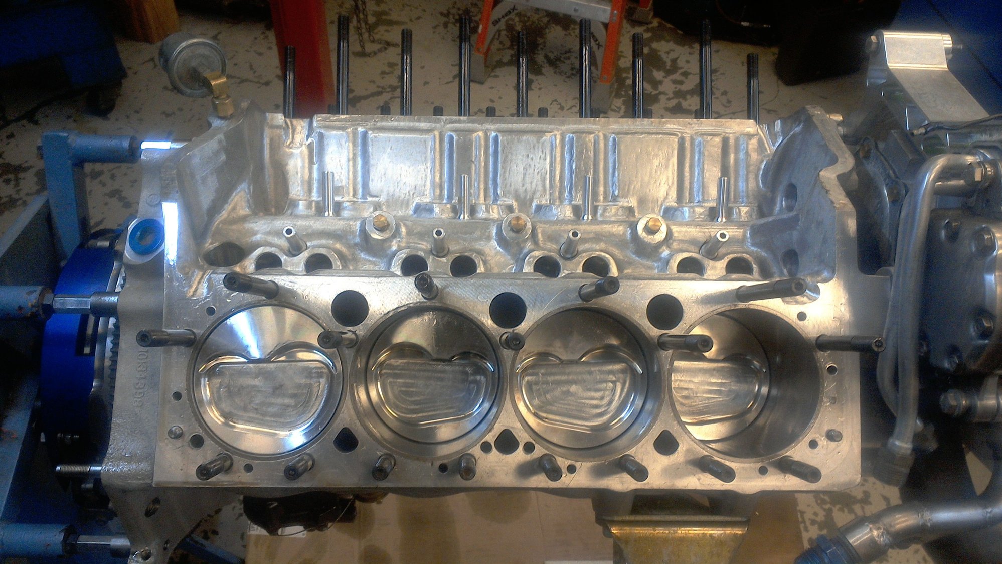

Piston Rods back in. Had to remove one Stud for each Cylinder to allow Ring Compressor to fit in there.

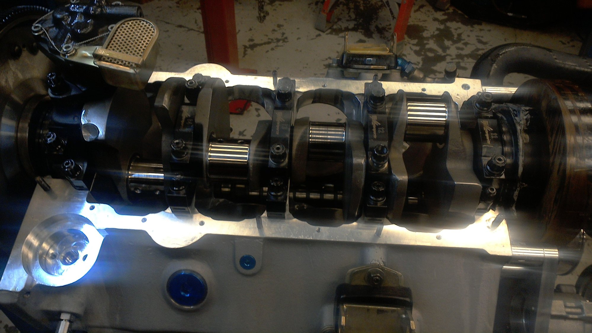

Crank all looks good. I have decided to replace the bearings anyway.

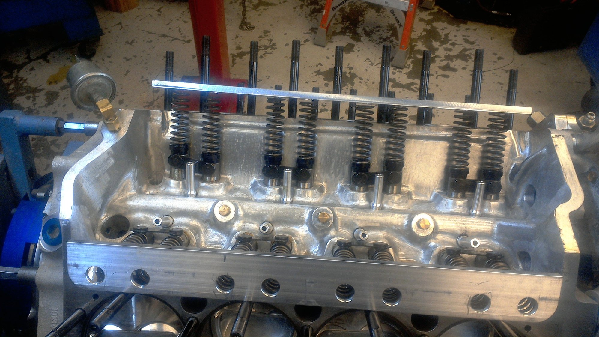

I have never dealt with a Rev Kit before but by loosening a couple of Studs I was able to pull the Heads down over them.

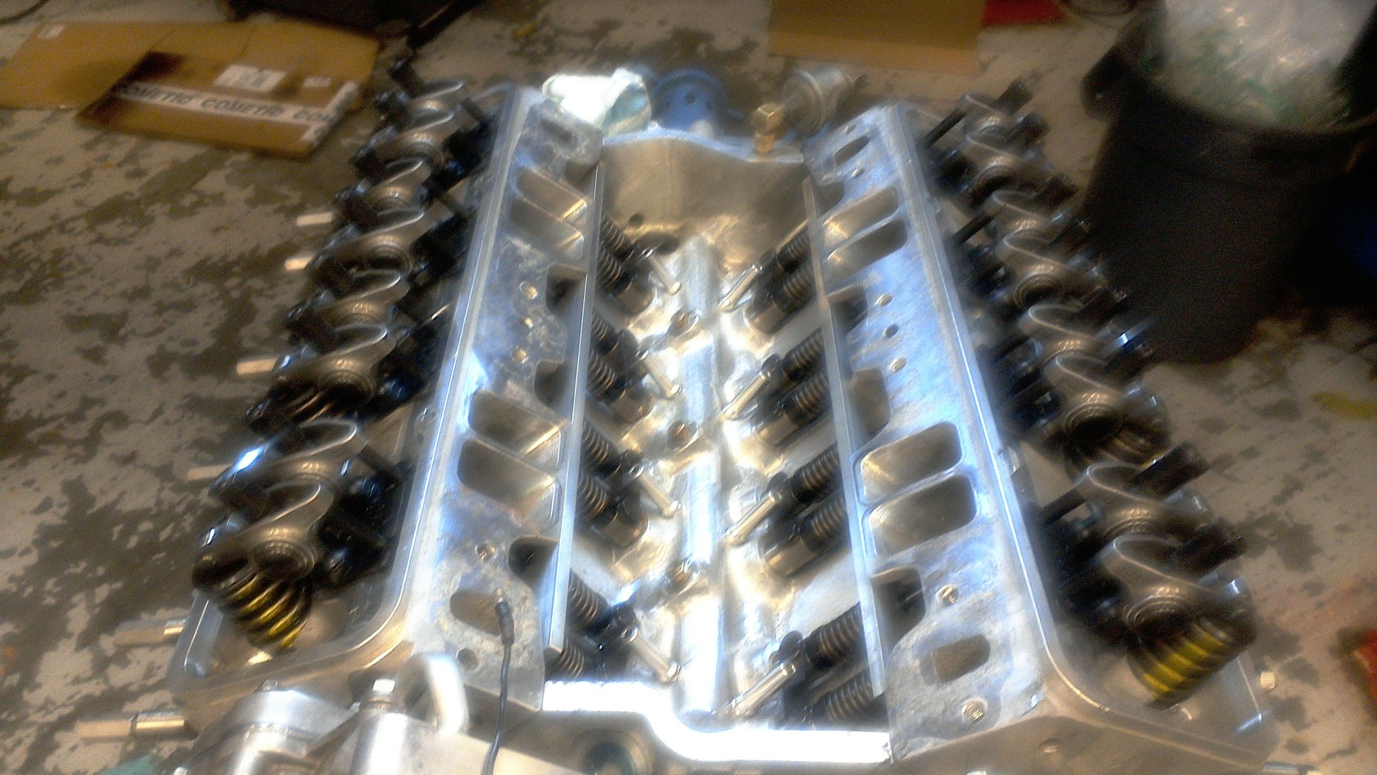

Heads are back on its time to adjust the Valves. Sounds like Comp Cams wants 1 full turn compressing the Lifter. ( Hyd Roller Cam)

Check your Comp instructions for hydraulic roller lifters. There is an old page stating lifter pre-load is "one turn of the wrench on the rocker arm adjusting nut past zero lash".
The date on the bottom right corner of the page is 3/22/12.
There is a revision to that page dated 1/24/13 that gives the lifter pre-load at 1/2 turn past zero lash. Or you can check with Comp to be sure.

Wish I would have caught you sooner, I would have strongly recommended pinning both the main brgs and the cam brgs.
When those alloy blocks get up to operating temps much of the "press-fit" (or "squeeze") on all the components almost disappears. Been doing both procedures for many years now, plus a few add'l.
Also, take into consideration with all the pieces "growing", I might consider more than that 1 full turn on the adjusters. Can't help too much with that dimension on the all-alloy/retro-hyd roller platform, we don't build any based on that setup.
I can say with the solid-roller units we set the valve just enough to get the units fired-up, we actually gain over .020" lash at running temps. Cold setting is down around .005" (nominal).
Thanks, Gary in N.Y.
P.S. For anyone else interested here's a shot of the pinned main brgs caps from one aluminum block, only need the front 4 done.

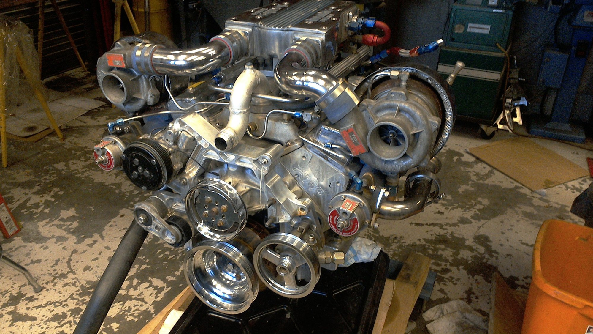

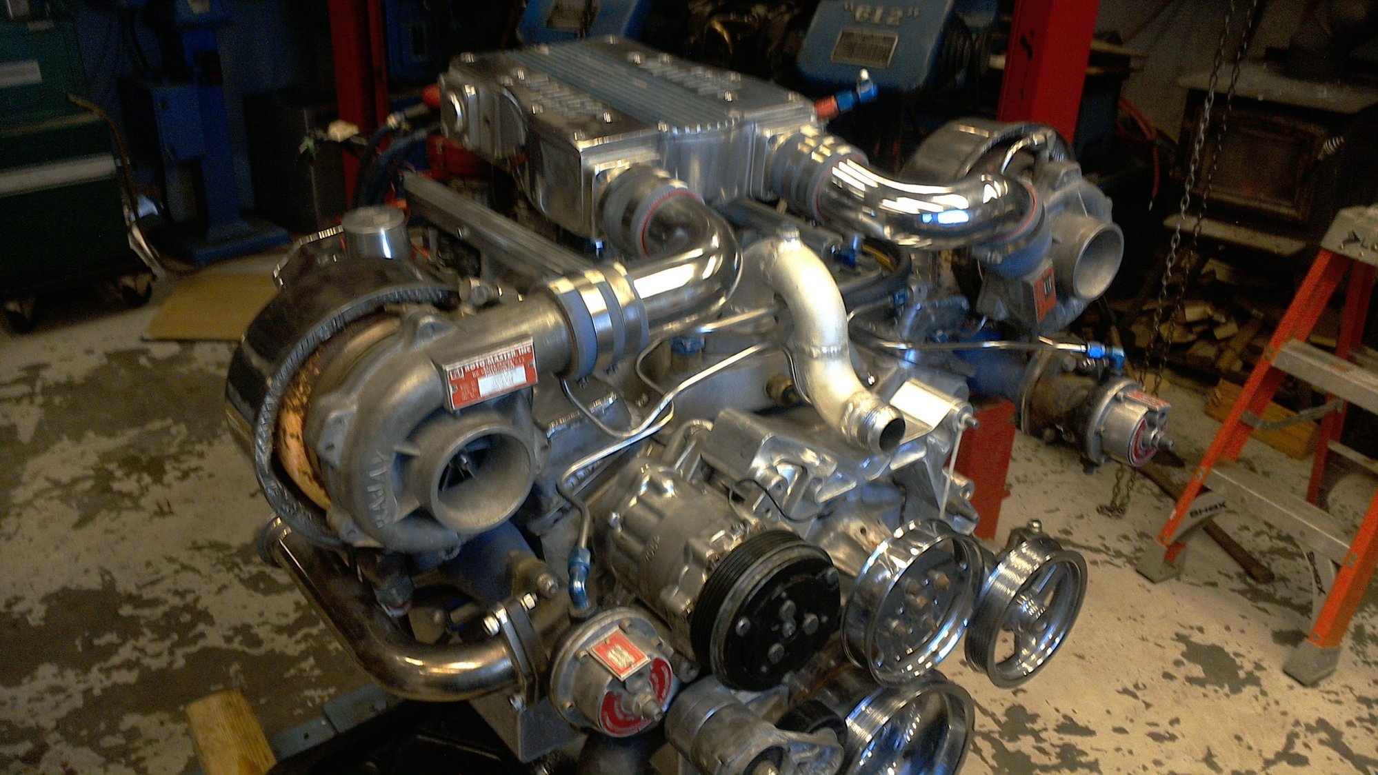

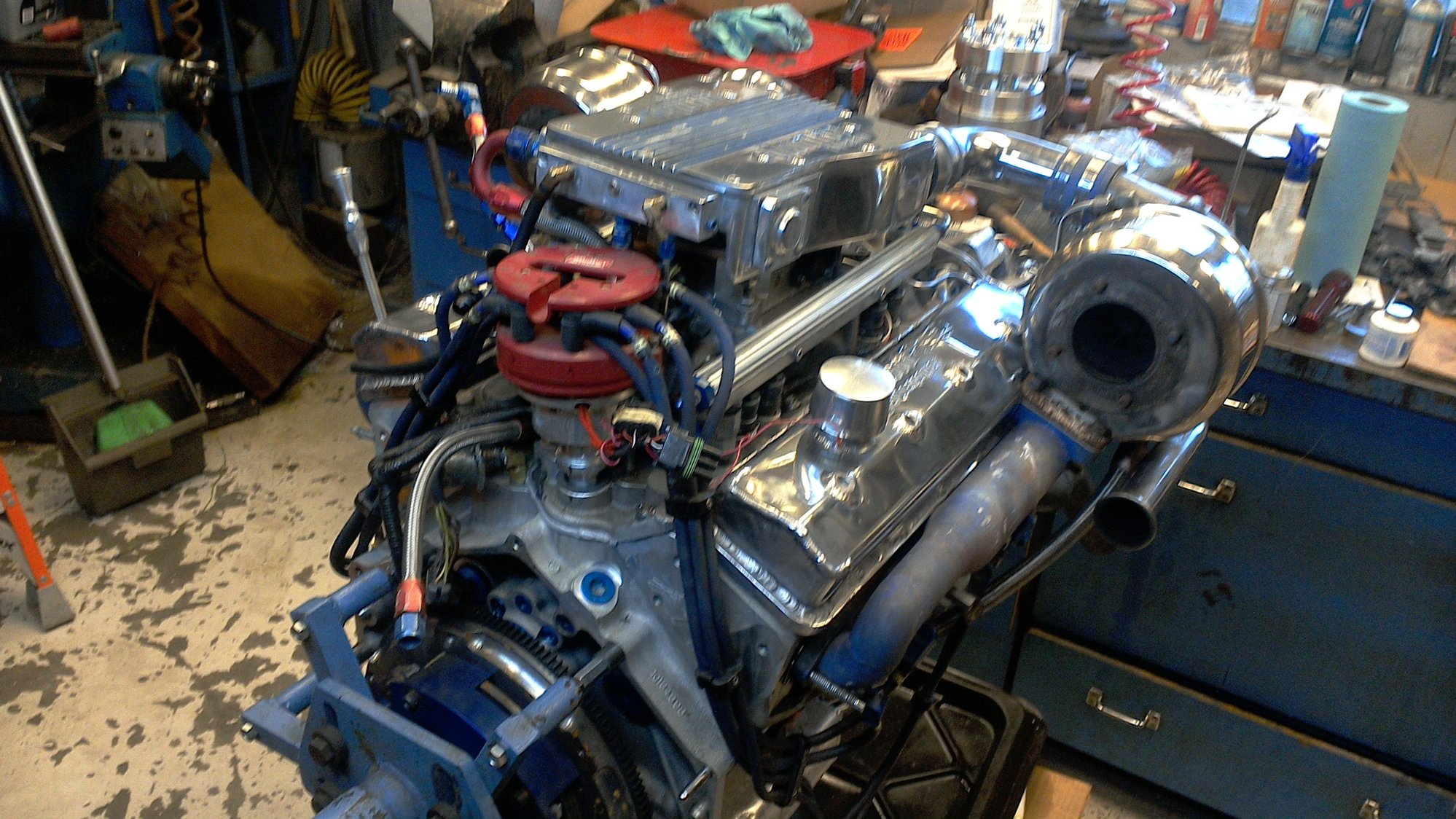

More Progress Today !

I will definitely be calling Comp cams tomorrow. To adjust the Valves obviously the valve Covers need to come off. To get them off the Turbochargers need to come off. To remove them the Exhaust Manifolds need to come off. To take them off the Motor needs to come out of the Car....

I could see pining the Bearings due to growth but probably not in my application. This is predominantly used as a street Car that goes to the Autocross Track. Long straightaways end up being a lot shorter with this motor. I did the Nevada 100 in 1993 with an Iron Block version of this Motor but I can say as of late, The older I get the faster I was...

Banks did a lot of work to package all of that cleanly...except as you noted...way too hard to work on. When I was designing mine....ease of pulling plugs and valve covers was critical.
Definitely want to get that valve adjustment right the first time!
What rings were in it? Did you do anything different this time? Got any pics before the hone of the cylinders and pistons?

The engine was not assembled by me the first time around so I can't say for sure what rings were in it. However I bought rings from JE piston when I had the pistons made and I don't see why they wouldn't of gone in. I'm putting JE rings back in this go around so they will probably be the same thing.
