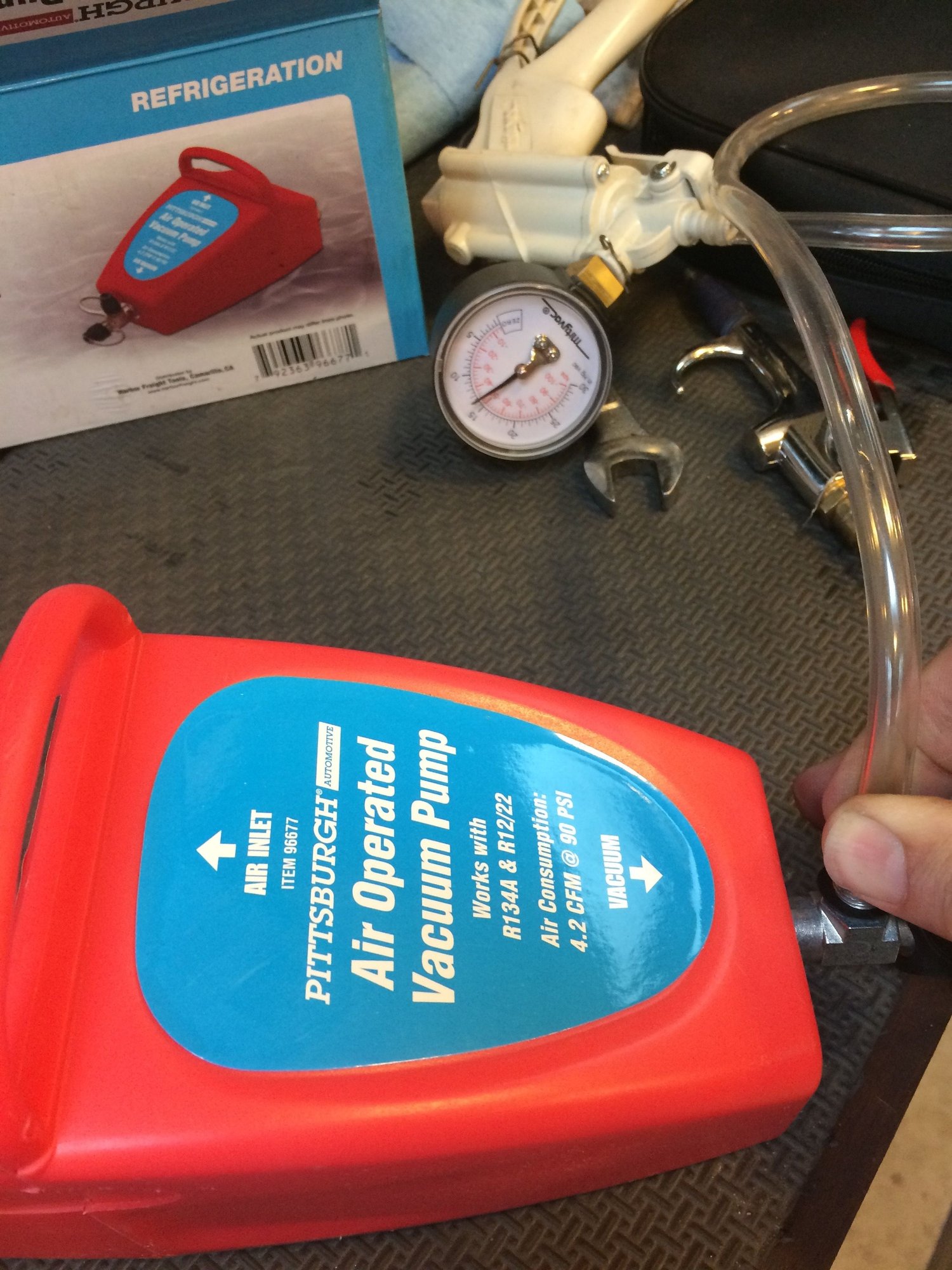

Just an update for anyone who may be interested. I now start the restoration of my vacuum system. As promised I purchased the Harbour Freight Vacuum generator.
Control Vacuum very easily from 0 to 30 inches depending on how many PSI from your compressor. Though it may blow up in a couple days, so far so good. I give it a 9 out of 10 for now!
Pete
completely variable stable vacuum supply form 0 to 30 inches,,,,, just vary your compressor output
Pete
I kind of always worried about my compressor too when I used that venturi pump to vacuum down A/C systems. I limited it to about 20 minutes at a wack to give the compressor a break. Never did blow up the compressor. If you got a "dry" air compressor, your on your own I don't know how robust those things are.
