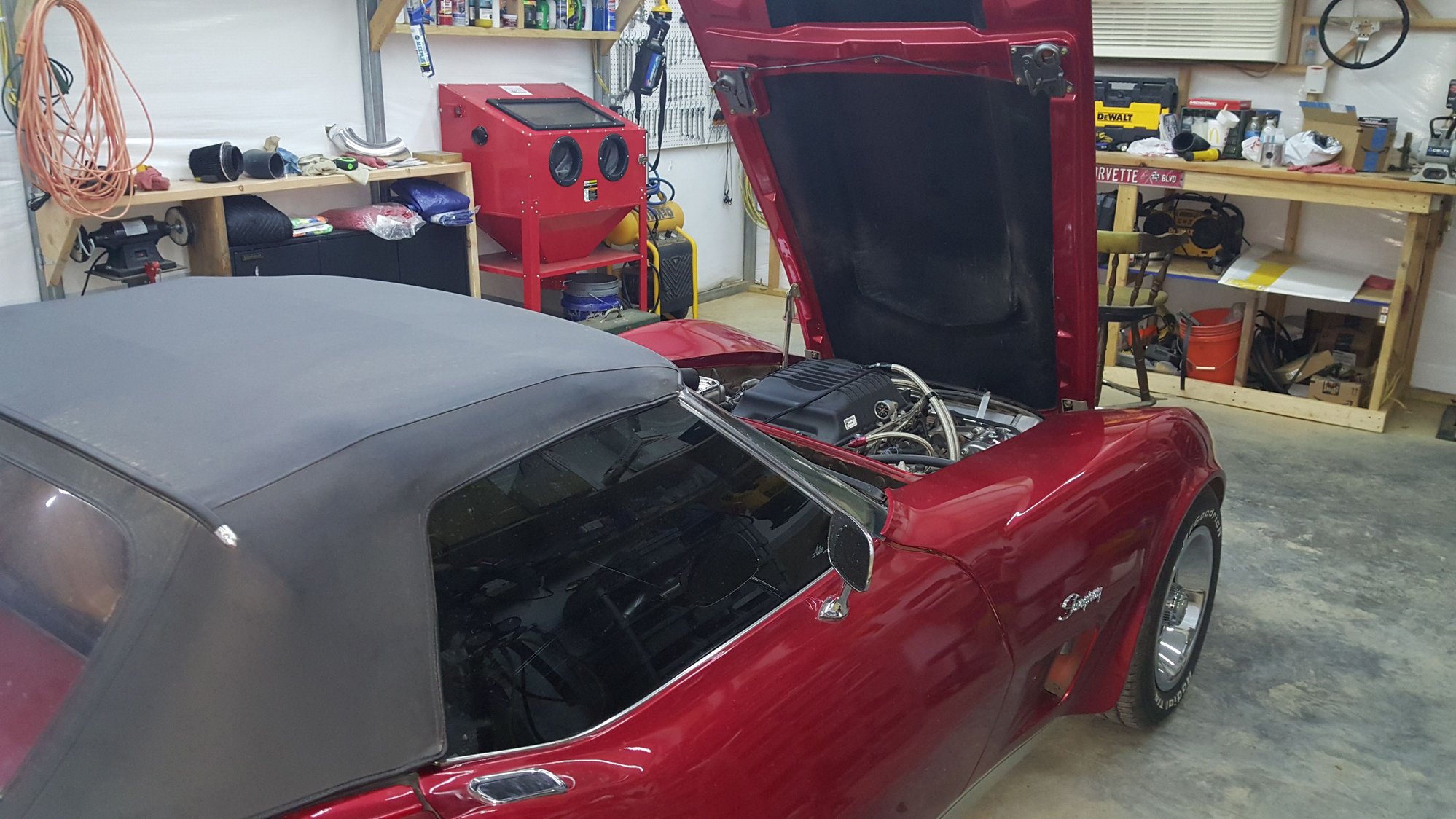

1975 C3 w/ factory off road package and 4-speed manual. hooker headers and side pipes. When I purchased it also came with a new 383 stroker crate motor already installed and dyno tuned
Best:
Added MSD 6AL-2 Programmable 6530 multi spark ignition system for cleaner fuel burn, increased low rpm performance, more stable idle at low RPM, Rev limiter function and much better manual transmission control at low rpms.
Large capacity HHO Hydrogen generator from ebay to reduce idle fumes/cleaner fuel burn/lower engine temp. Mostly so I can breathe cleaner air idling at stoplights with the windows down lol. I am curious to add 2 race grade catalytic converters to see how much of a difference it would make with reducing the remaining exhaust fumes.
2.5 Farad Capacitor at the MSD control box and a 3.5 Farad Capacitor at the HHO generator with marine terminal battery distribution blocks in the center dash for the added MSD and HHO generator wiring and custom on/off switch panel (MSD on, HHO on, Sub amp on etc
Electric headlight motors
Removed side pipes and hooker headers. The fumes from the side pipes were so strong at stoplights your eyes would actually start watering after a while and everyone would burn their leg on the side pipes when getting out of the car)
Installed 3" custom six muffler dual exhaust with x pipe configuration because the stroker engine is so ridiculously loud. (headers into Pype's M-80 Race Pro Muffler out into flex pipe at cross member bar into Cherry Bomb Vortex out to generic ebay 4" Slant Tip / 3" Inlet Stainless Steel Spiral Flow Exhaust Muffler w/ Silencer to finally reduce drone in the back). The engine bay itself actually seems louder than what comes out the back of the car now and I can finally listen to music all the time while driving.
Interior Waterproof Sound Insulation Heat and Cool Liner in the rear storage compartment to reduce drone even further.
Custom sound setup with BMW low profile subwoofers
Removed Thermostat to reduce coolant heat pressure and increase coolant flow (I might try drilling relief holes in the thermostat next if I decide to reinstall it for winter)
Stant 10330 Lev-R-Vent Radiator Cap (I leave the cap lever vent open during summer and closed during winter)
Heater core bypass hoses and valves (heater core bypassed in summer since I do not have AC yet)
Generic universal aluminum baffled oil catch can MINI 3-PORT from ebay (this completely collects any water vapor that would build up in the engine oil even running very low temp without a thermostat installed. The inside of the valve covers are always clean now)
Installed rubber sway type bushings between steering column bolt holes and dash to reduce whole car idle shake at steering wheel at stoplights. Somehow installing the bushings between dash and column also removed almost all of the slop from the stock steering which was a surprise bonus. I think maybe because the column sits at a slightly lower angle now with this done. I cut the sway bushings in half and ran the column bolts through. basically made 2 thick rubber washers from one sway bushing.
Chrome Bumper Conversion (reverted to 72 style using a rear bumper from custom image corvettes and replaced the 1 piece front clip with a 72 clip for front chrome bumpers. I used turnbuckles and steel rope wire to attach and align the front clip instead of permanent bonding strip attaching it to the car which would be a bad idea and possibly de value the car. Front clip is still completely removable if needed. I used various large bushings when attaching the rear chrome bumper so it actually flexes without putting any stress on any of the fiberglass)
Added Trailer hitch during the custom rear bumper install
Added chrome luggage rack
Generic universal Dual Cup Holder from ebay
Worst: Not yet having spreader bar and Borgeson 999032 steering kit (I am not sure if that I should have a final front and rear alignment done without it even though steering slop is now gone) another worst is maybe not yet having the engine timing dyno tuned with the upgraded carb and MSD programmable ignition for optimal performance. And maybe not installing LED bulbs while I was re installing dash.
