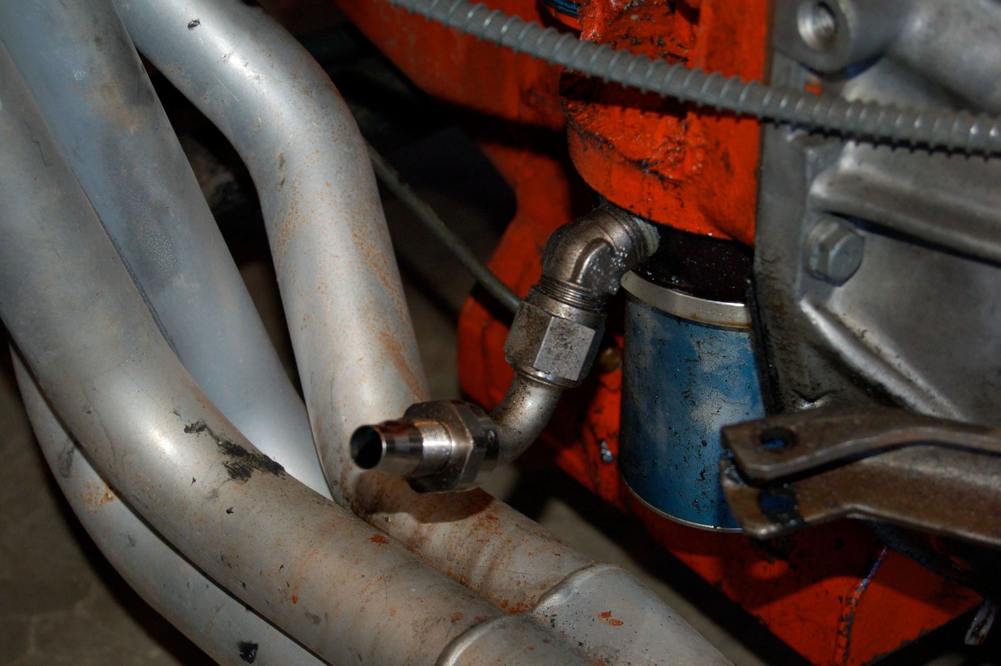

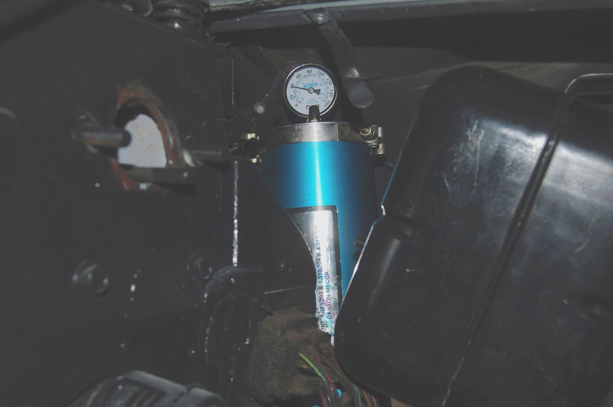

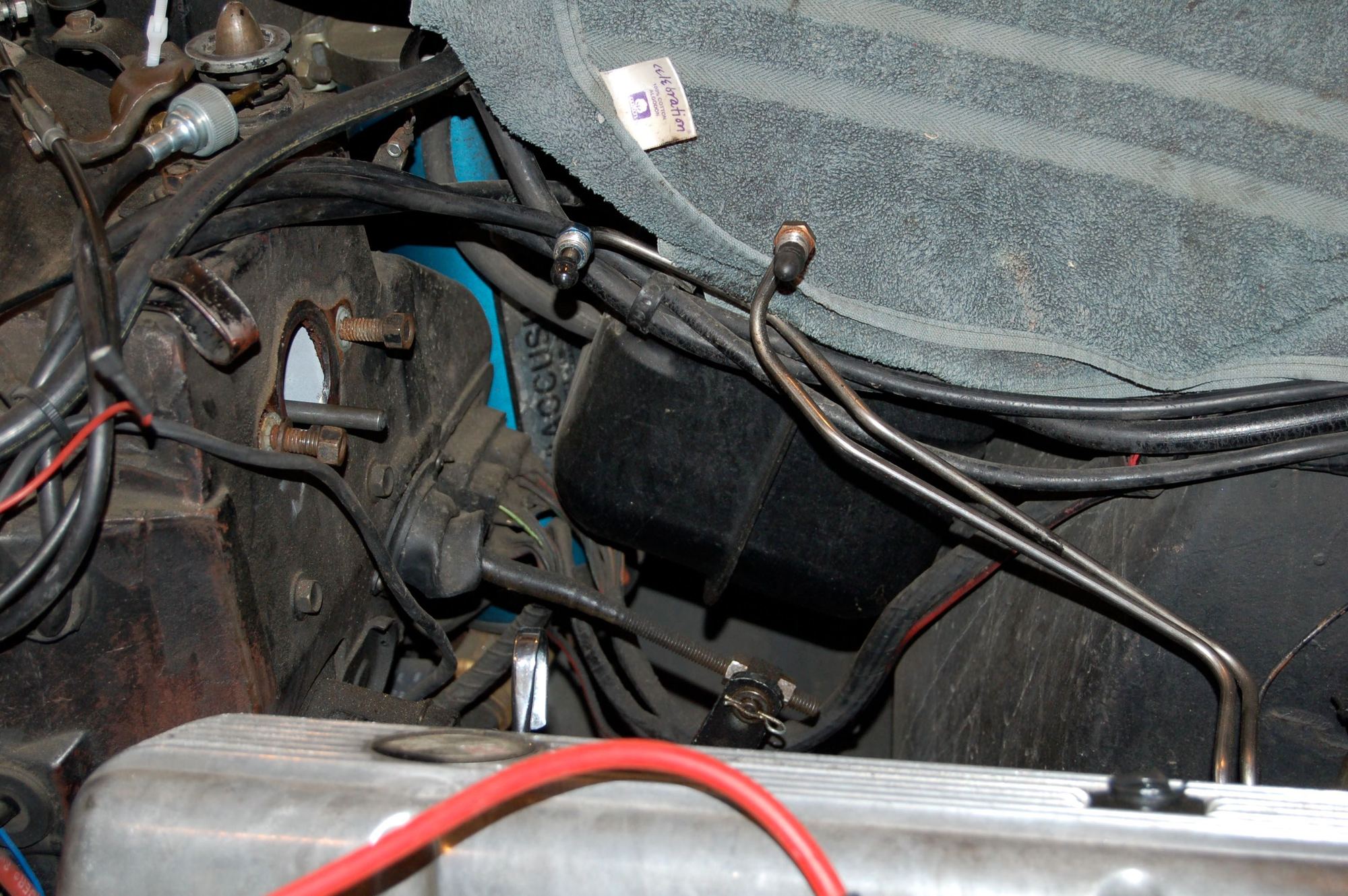

Here's part of my plumbing.
I have pictures on too many devices, I really need to use the cloud. I thought I had a picture of the accusump mount itself, it was a very tight fit. Found another picture!
I also used the electro-mechanical valve they sell tied into the ignition. At least that wiring was close by!
One more!
These may not tell you all that much. As I remember the mounting was pretty tricky I put together some sort of teflon wedge to mount to the body and then strapped the tank to that.
My primary purpose was for auto crossing, especially hard braking where I could watch my oil pressure just disappear.

Stuck my head under the car today, and it sure looks like it's going to be fun (but obviously doable from Ignatz's picture) getting the Accusump mounted under the LF fender.
