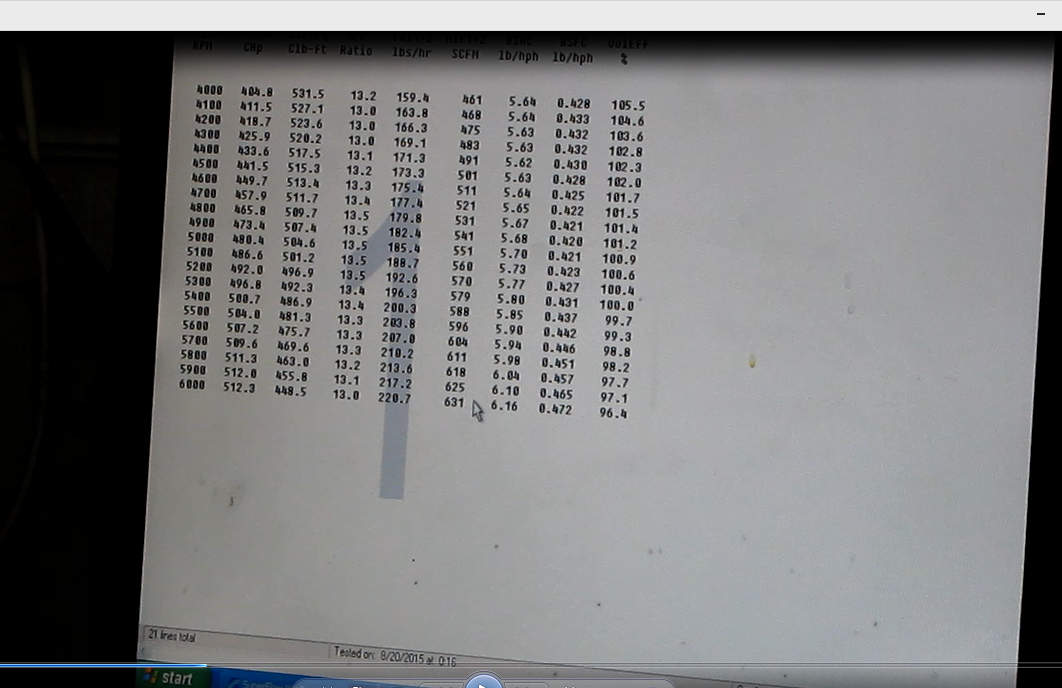

Profilers need around a 6 degree split. A 210cc head on the 383 is on the large side for a street strip combo. I would suggest a something like a 230/236 on a 109 LSA. That will give the best average power under the curve and peak around 6000 rpm putting a shift point at around 6300 or 6400.
This is a 406 with a set of 210 Profilers and similar cam.
