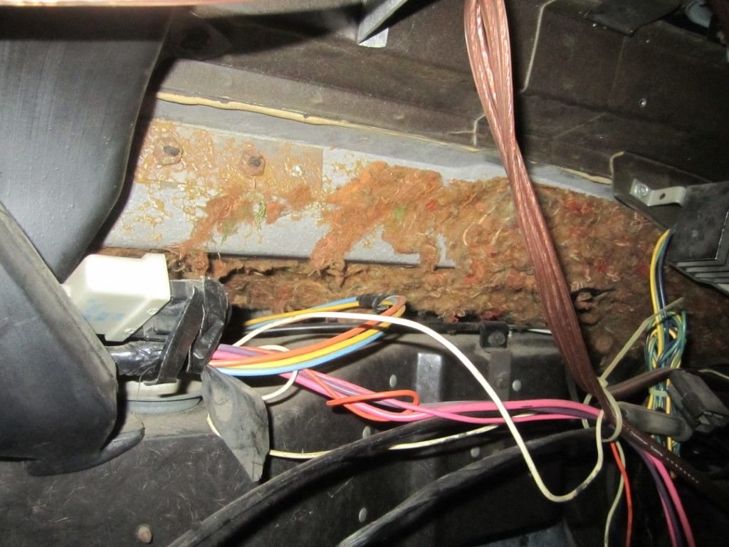

is this the flasher? I think you said this was the turn signal flasher? any thoughts on a replacement? has someone been successful on re rigging/wiring an alternate? mine is totally gone!
bob
On my '78 my turn signal flasher was round... I can't confirm if yours is the right one or not though...

Old Jun 13, 2018 | 06:36 PM
Mooser's Avatar
Mooser
Joined: Apr 2011
Posts: 11,183
Likes: 3,335
I think that's your seat-belt / key reminder buzzer.
M

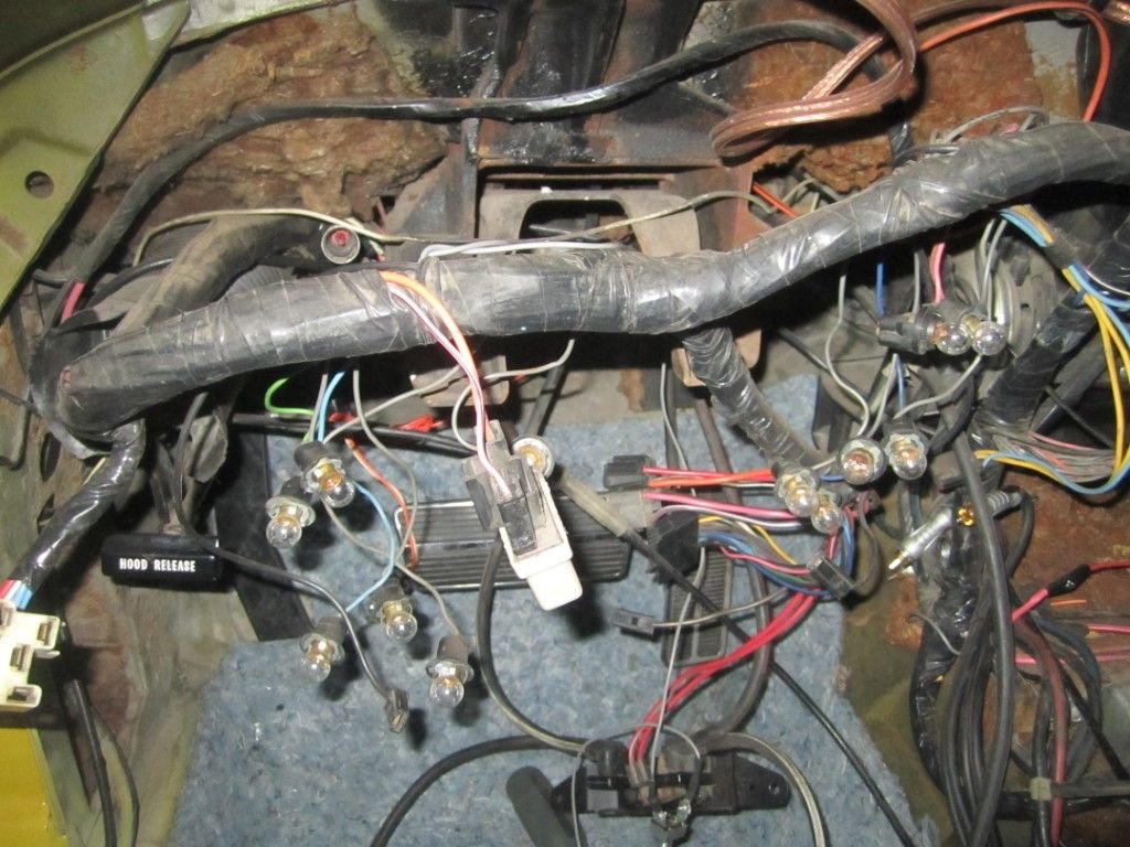

Maybe, but I thought this was the seatbelt reminder buzzer, this sits in dash in front of the drivers side.

That's weird, yes that's the same part number as mine (ignition/seatbelt) but that other part I'm pretty sure is a buzzer, is there a round grill on the other side of the white part you showed?
Old Jun 13, 2018 | 07:51 PM
Mooser's Avatar
Mooser
Joined: Apr 2011
Posts: 11,183
Likes: 3,335
I'll have to check my pictures, I wonder if they had separate seatbelt (the one on teh passenger side) and ignition key (the black one) on the 72
M
Old Jun 13, 2018 | 08:01 PM
Mooser's Avatar
Mooser
Joined: Apr 2011
Posts: 11,183
Likes: 3,335
Yup
Seatbelt warning buzzer on the passenger side
Ignition Key buzzer on the driver side up around the gauges
both same part number (6262663) and both of mine look like the white one you showed
M

OK, well ... it looks like the votes are in. both locations are some sort of buzzer. so, i'll get another 6262663 and put it in the harness where the tung-sol 902/022 was plugged in! lets hope for success. that's for all your support.
