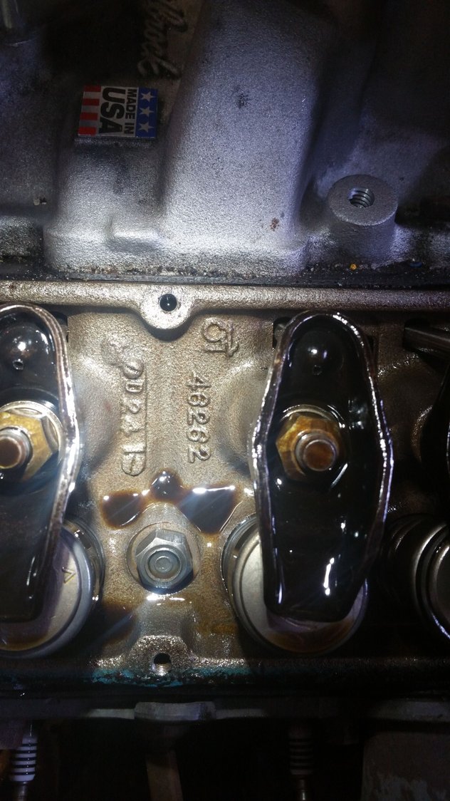

I was interested to see what heads I had on my 81 C3 and the casting number is 46262. Everything I see online is for a 462624. However mine does not have a 4 at the end. Am I missing something?

The Book Corvette by the Numbers doesn't have this head. So it could be that it did not come on a Corvette. But the April 24 1981, 1971 or 1961 casting date would indicate that it left the factory on an 81.

At least I know the year. Still can't find any thing specific about thsee heads.

Hi U,
This is so close but not quite right…. you seem to be one digit short?!?
Regards,
Alan
462624
350
76-87
1.94/1.50 2.02/1.60
76cc Crack prone

That's exactly what I found. Seems odd to be missing a digit. I can't imagine that is normal.

Hi U,
I wouldn't think so either.
Is it possible that when heads were made for 'service' the # had a different number of digits?
