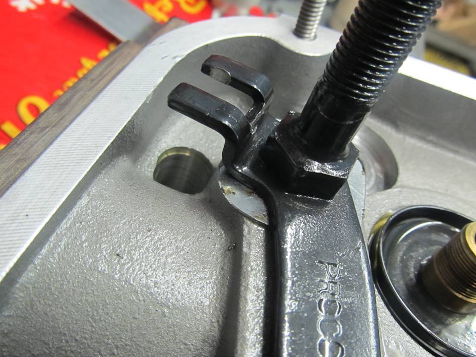

Brand new ProComp/Speedmaster head on BBC on the dyno. 2nd pull
Old Jan 20, 2017 | 09:48 AM
StraubTech's Avatar
StraubTech
Joined: Jul 2013
Posts: 1,299
Likes: 93
From: Tri-Cities TN
Another engine, Ford. After 1 dyno pull:

Any set of assembled heads needs to be pulled apart and checked. That average hotrodder will not have the tooling to do this so i would encourage anyone to take a set of heads to a shop for a once over. We had a set of $7000 heads in the shop that some fell asleep on the guide clearance.
