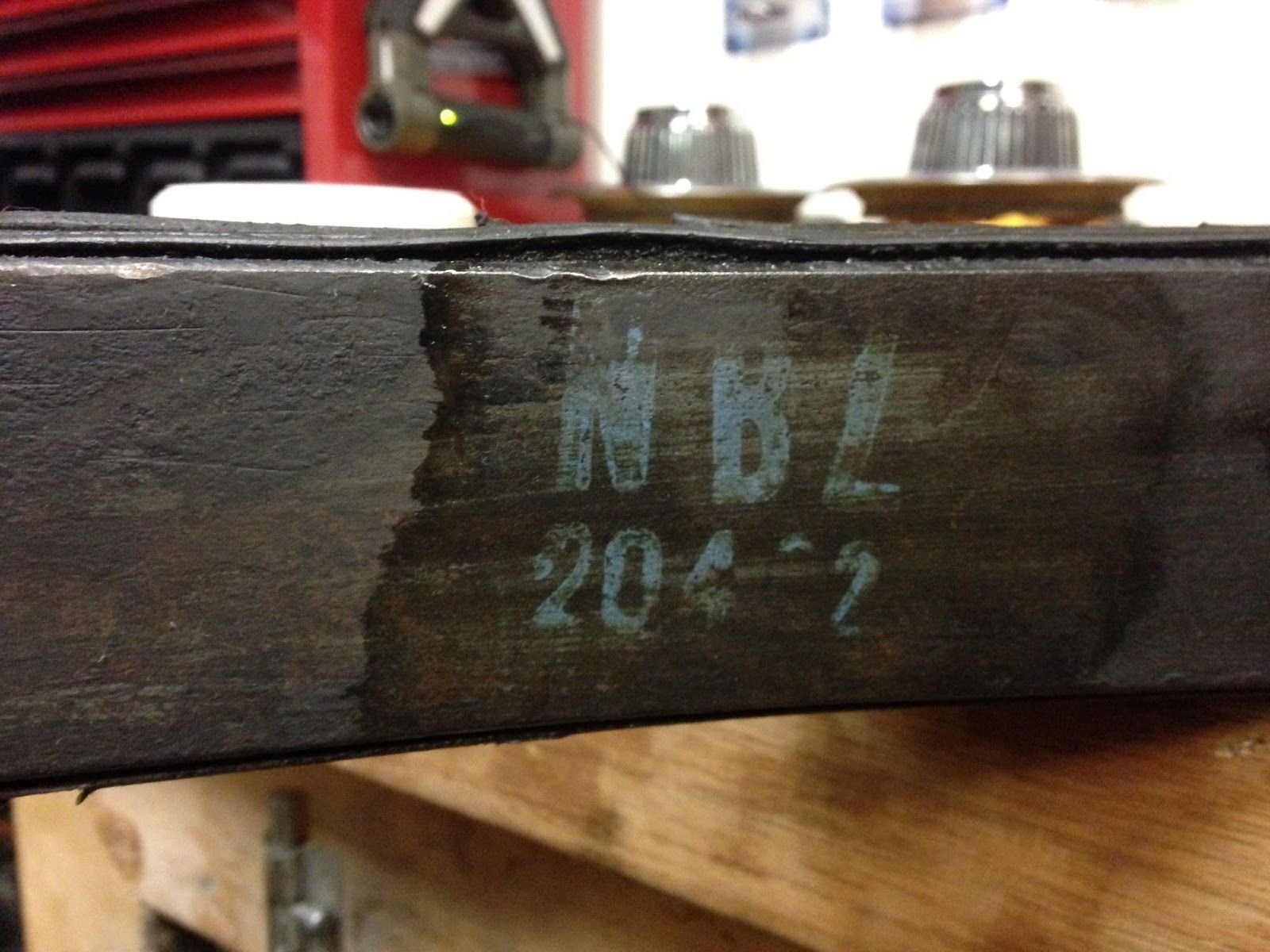

I think I have 10 leaf spring on my 72 and as I understand it's a dealer replacement or maybe a used one off a 75 or 76....? It appears to have NBZ/2402 stamped/stenciled on the bottom. On a side note does anyone sell the plastic liners in a roll...?

The NBZ is the broadcast code and would be printed on the buildsheet beginning in 73. I suspect the code is consistent with a 75/76 rear spring. The 20432 is the last five digits of the part number. The same year AIMs would list the spring part number.

Hunt...Thank you for the info...I see no way this was original to my car, but this spring has been on the car for quite a few years.

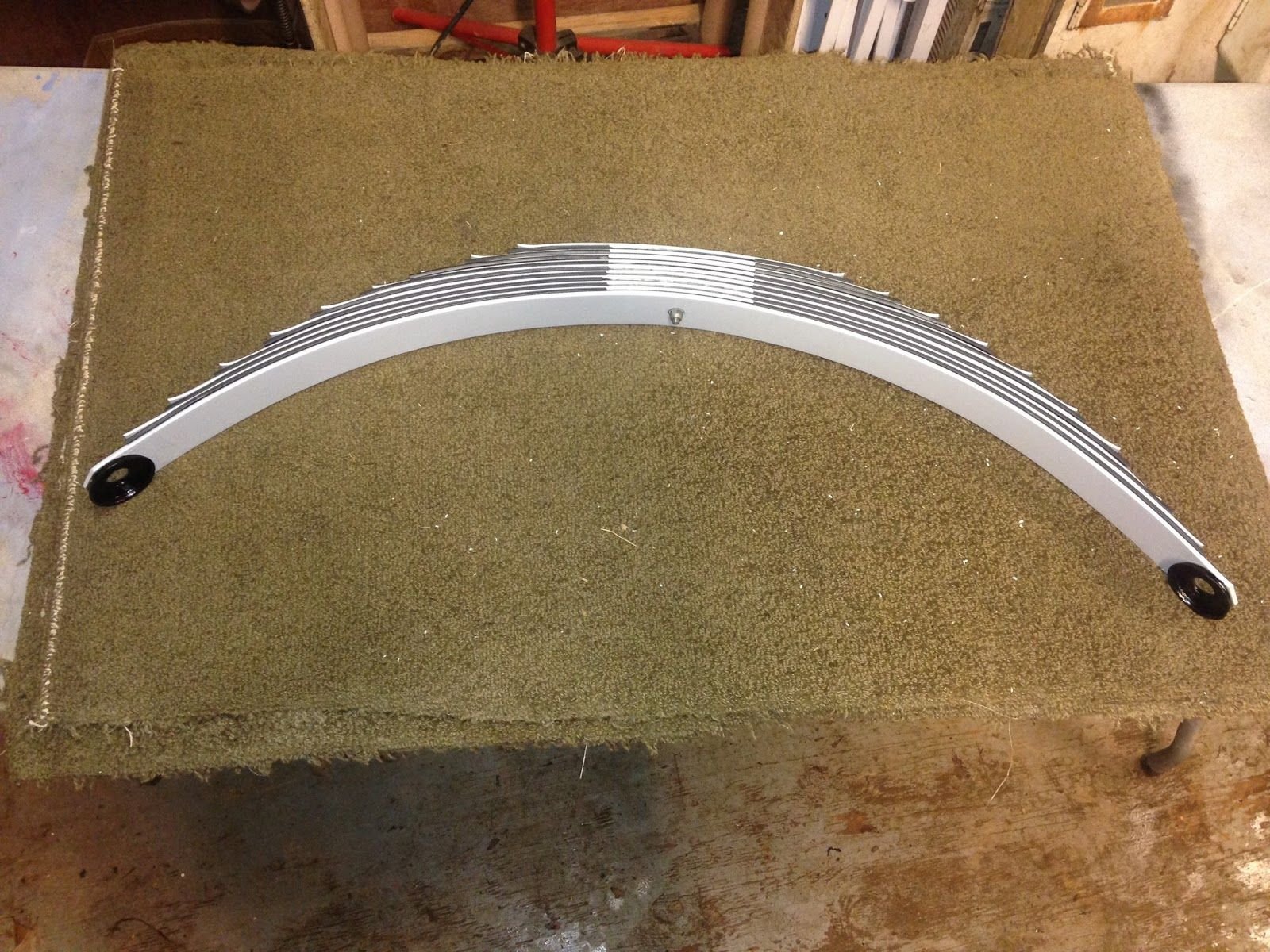

Well I finished up the spring....I did kinda have a hiccup with the bulk roll of liner material I bought off eBay....It was listed as 26'-6" and I needed right at 23 feet....When it came in it was only 19 feet long....I contacted the eBay seller and within 20 minutes he had refunded all my money and said to just keep the roll that he had made a mistake when he listed it. What a stand up guy... His eBay user name is coreycamaro.
I ended up having to reuse a couple of the old liners. I hope to get it back on tomorrow night....Just a reminder to anyone reading this and doing the same...Do not torque the spring to differential bolts till it's back on the ground.
It's painted light grey but looks white in the pics.
