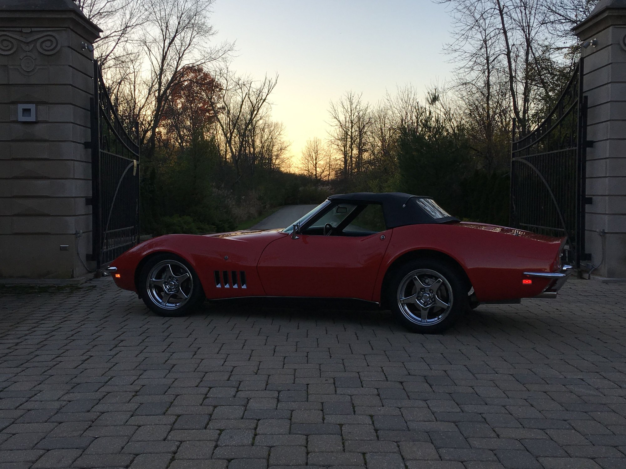

I have the front and rear kit, the car rides much better. Mostly because I can dial in the shocks to my liking, then fine tune the rebound and compression for the roads here.
I still keep the half shafts adjusted correctly 1/2" higher with the inner and outer u-joint with 1/2 tank of gas.
I also used the VPB heim joint smart struts with lowering bracket.
I think it handles great but I have no clue what it would do at the limit.

Your ride height is impressive. I too have a roadster. My point was that I didn't want to sacrifice ride for being lowered. What tire dimensions do you have? What are VPB heim joint smart struts with lowering bracket?

I still use a 27" tire same as the stock 15" tire
