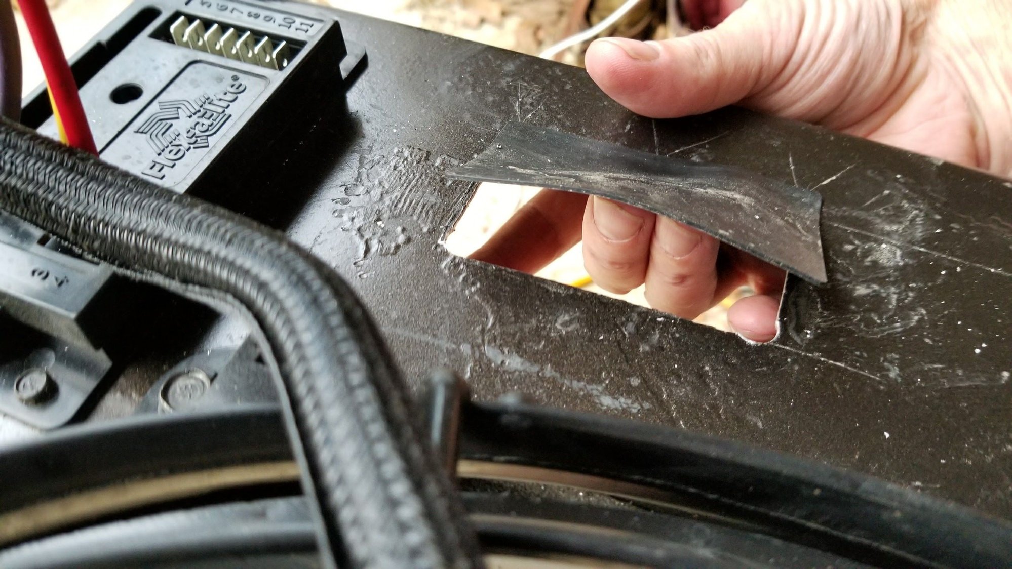

Mine is installed in the upper right corner of my baking pan fan shroud.
