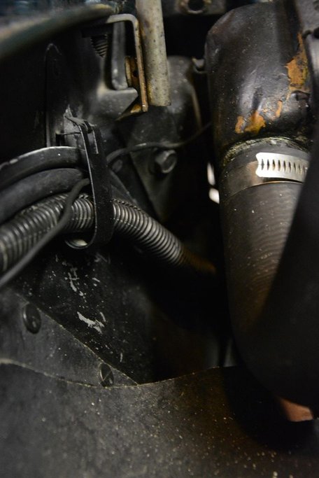

Just did the same in my '79. No need at all to remove the hood. What you really need is a helper. Beginning with the passenger side lamps, feed 1-2 connectors through at a time. One person is feeding through the connectors (working on either side of the radiator) while the other holds the rest of the harness out of the way and reasonably taut.
Here's a photo but I don't know if it will be of much use as the "slot" that the harness passes through is both small and hidden to the camera.
