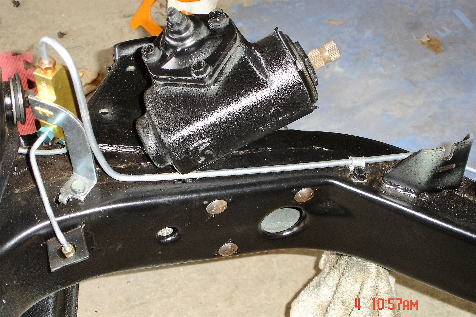

Here's a few pictures of my 1970 with Power Brakes.
70' with Power Brakes

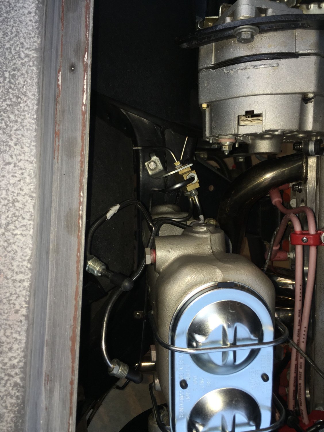

69 unit where you can clearly see the tab hole. FYI
RVZIO

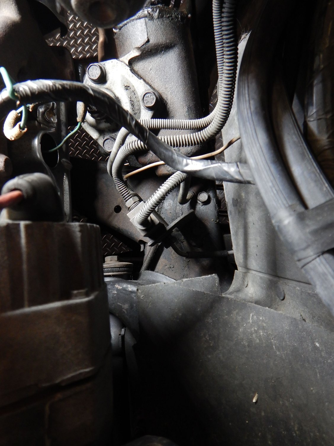

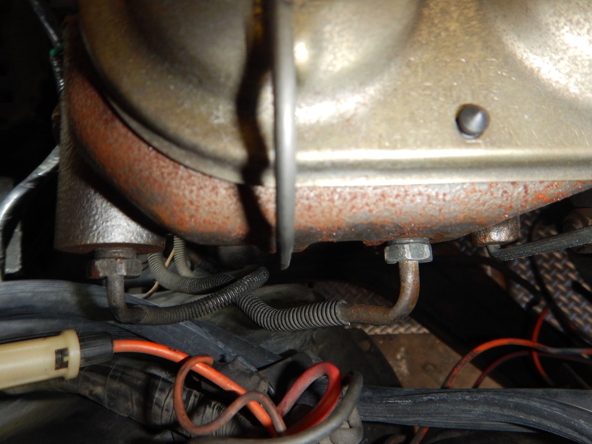

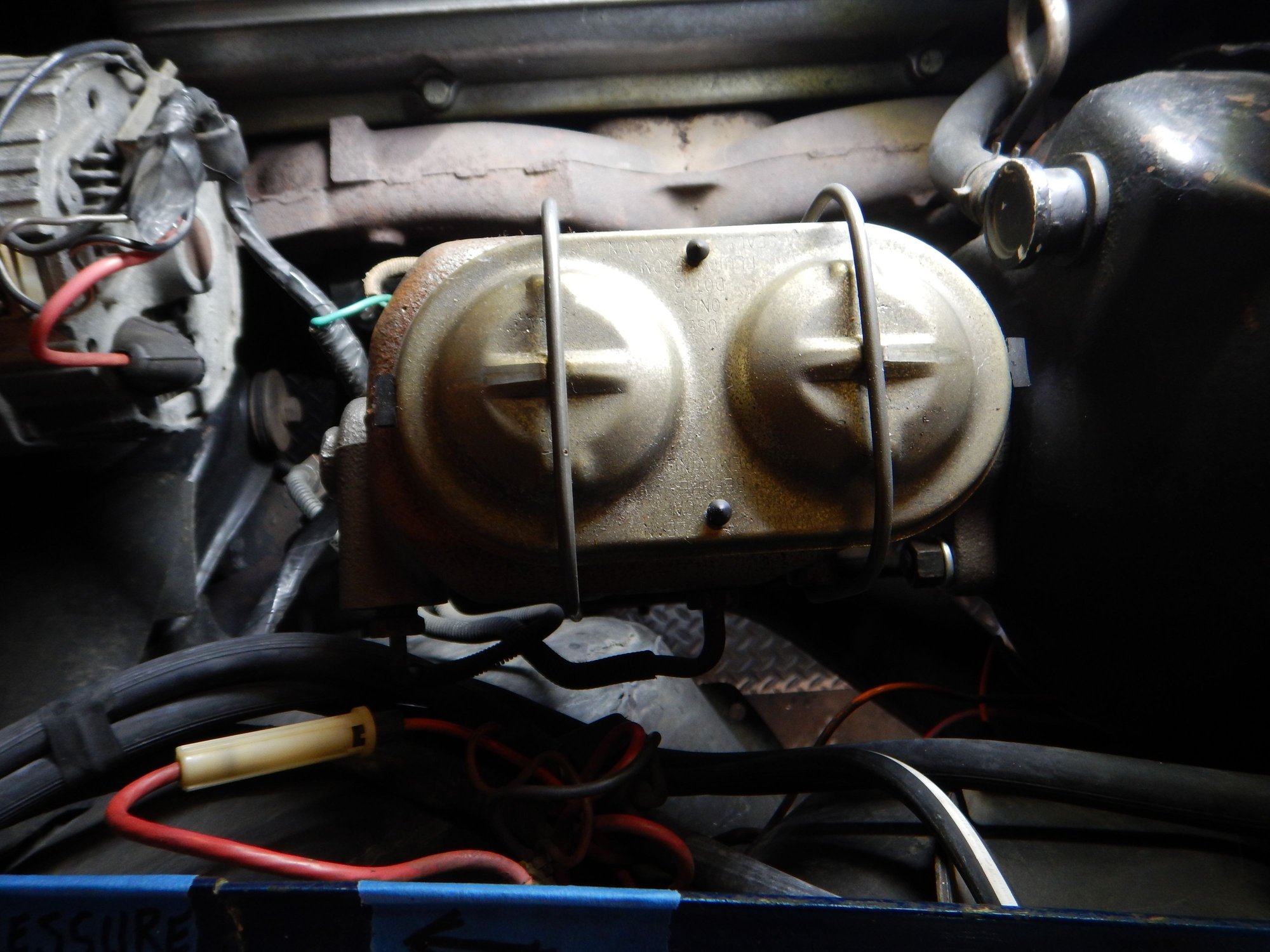

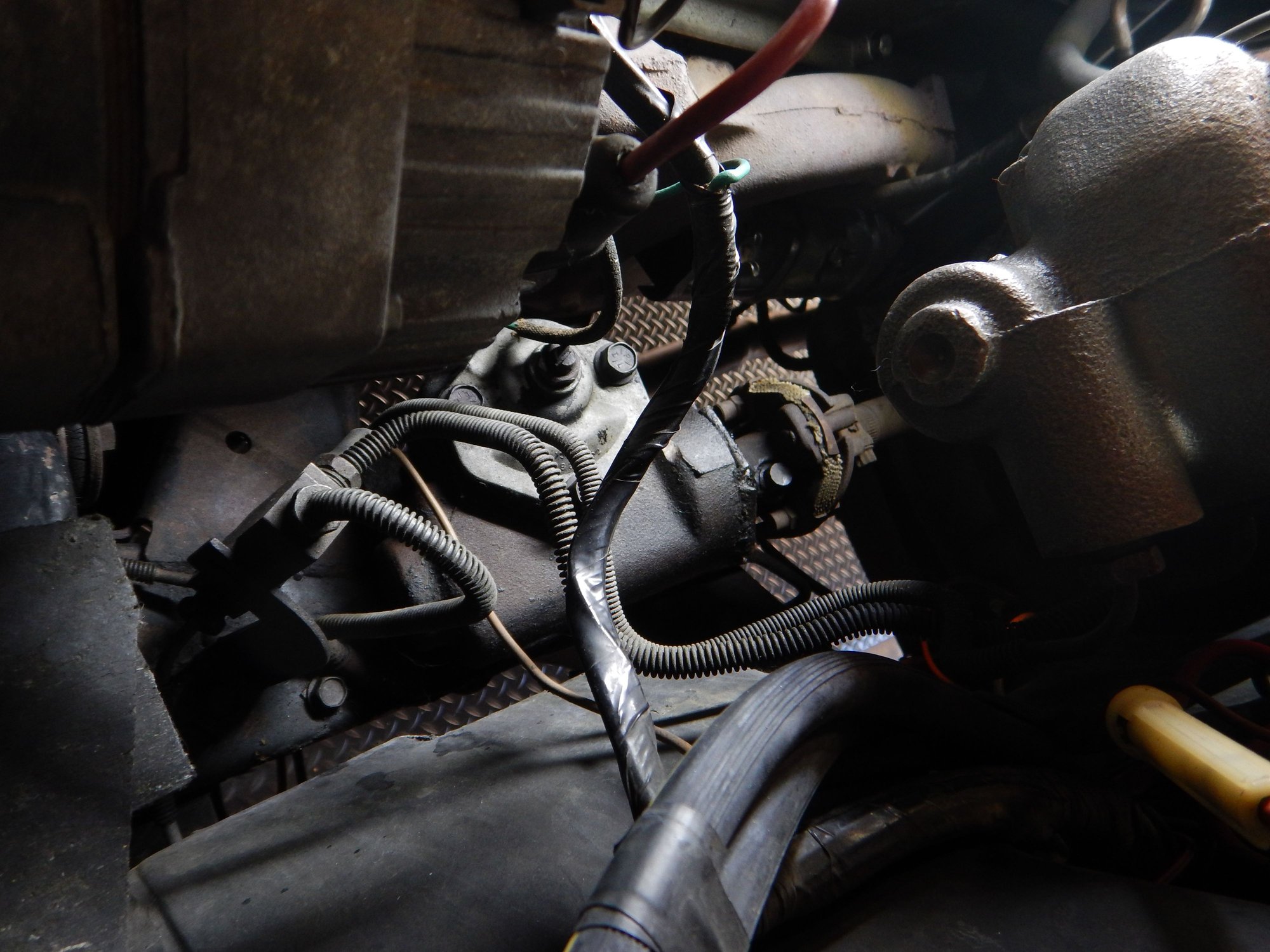

Here is a view of the lines on my power brake 73. They fit without
any modification.
Donnie
