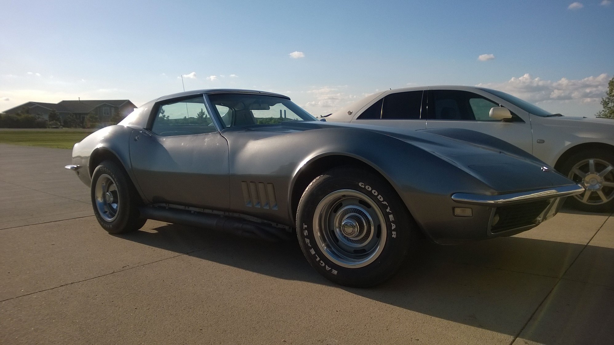

i have had my 68 for almost a year now, after getting the major issues squashed out i am on to the smaller things.
my question here is on my cars stance, i know getting a longer bolt for the rear leaf will bring her down some but the PO did this to the car
now with cranking down on the leaf that hard do you think that has caused any issues with the spring its self that i may have issues with if i remove the spacers? i inspected the leaf the best i can without removing it and there are no cracks or visible issues other than it being laid out almost straight.
(dont mind the small leak, that has been addressed)
i feel this needs to be lower all the way around is why i am asking, you be the judge.
thank you all for your input in advance.

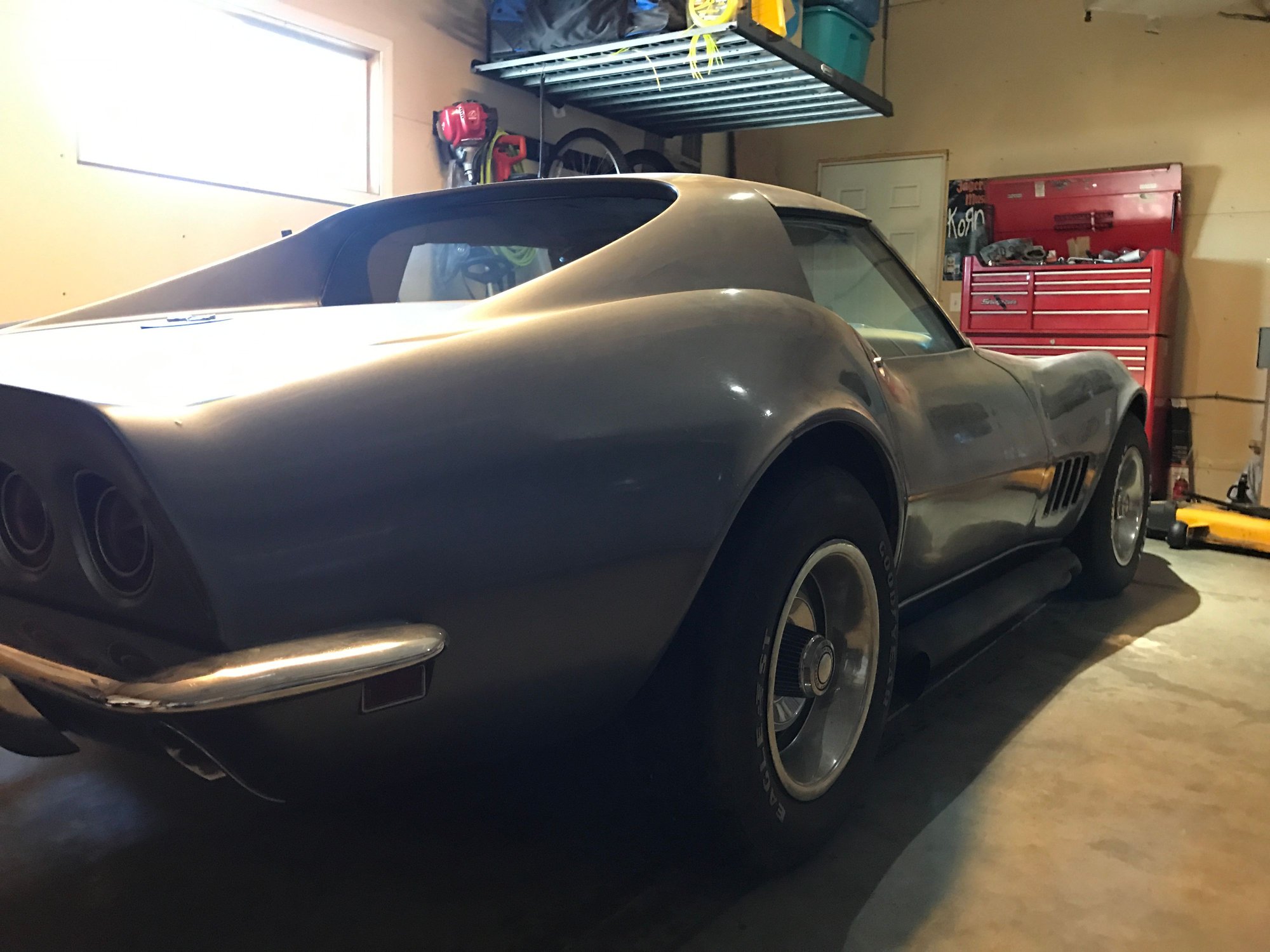

another angle of the amount of room there is in the rear

You can remove that spacer and put the bolt/washer/bushing package back to stock configuration. I assume they did that because the old original spring was shot and the rear was lowered too much for their taste. That spacer arrangement raised the rear about 2".

I think you need to follow DR's suggestion… return the hardware to the normal configuration, see what the ride height is, and proceed from there.
The typical dimention from the ground to the center of the fender arch is about 28" when the tires being used are about 27" tall.
What does the car ride like with that configuration?

i have 245/60/15's on there and will stay that way more than likely
the peak of the fender well to the ground is 29 3/4''
the front is at 27 7/8''
and the tires are at 25 3/4''
it rides a bit stiff it seems, but no worse than i would have expected really.

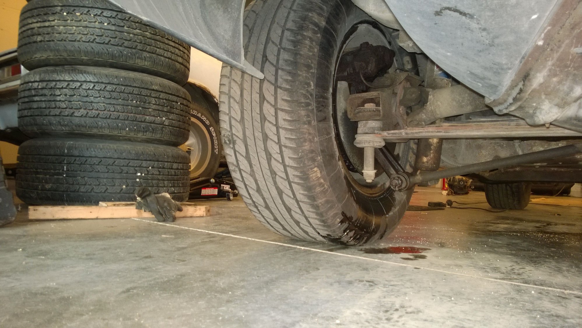

ok, so the car dropped about an inch on the pass side and almost 2 on the drivers side. the bolt on the driver side is longer and the bushings are also shot over there so i am going to need to get some new ones.
i tried running the nut up further on the driver side but where that spacer was riding for so long it took the threads off the bolt and made it impossible.
it was quite interesting removing these parts, one side looked like it was a piece of hollow bar stock where the other side was definitely a piece of black pipe for running gas line, had the threads and everything on it still
took it on a small drive and didnt seemed alot softer in the rear as well, small burnout test provided no wheel hop and didnt try to squirrel around unless instructed to.
here is a pic of the after and a shot of the hanger bolts
pretty sure alan is jealous of how clean this is
long bolt side, not sure why there are rubber bushings on the tops of the springs though...
seems to be the proper height on this side
still i bit high on this side

The extra rubber bushings aren't doing anything at this point.
Depending on the condition of the bushings that in their typical locations on the left side you 'might' put them there. (They look pretty worn out.)
A better look of the spring seems to show it's at least the original configuration…. leafs tapered and curled slight up at their ends.
