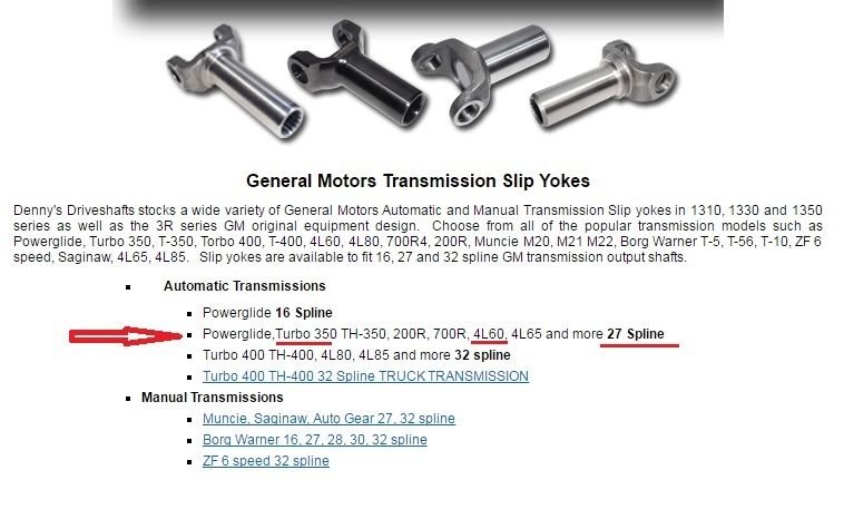

http://www.tciauto.com/tc/trans-dim/
I believe you can use a yoke from a T-350. It appears as though you may have to modify driveshaft length, cross member, and parking brake pulley if cross member is moved.
Powerglide 16 Spline
Powerglide,Turbo 350 TH-350, 200R, 700R, 4L60, 4L65 and more 27 Spline
Turbo 400 TH-400, 4L80, 4L85 and more 32 spline
http://www.dennysdriveshaft.com/c75_general_motors.html
I definitely could be wrong but I didn't think the TH-350 yoke would work; I kept my L82 engine but swapped the TH-350 for a 4L60e a few months back. I bought a new 700r4/ 4L60e yoke, had the drive shaft cut, shortened, and welded and bought the arched Bowtie Overdrives driveshaft to provide more clearance -now the exhaust runs under the cross member and the exhaust can be removed without touching the cross member.
Adam

The TH350 yoke should work fine. I have a Powerglide yoke in my 4L60e.
Adam
It was right in the dennysdriveshaft link I provided friend
The one thing OP may need to do is plug the vent hole (clean it & silicone it) in the yoke since the Vette is not a floating yoke and needs no vent.
