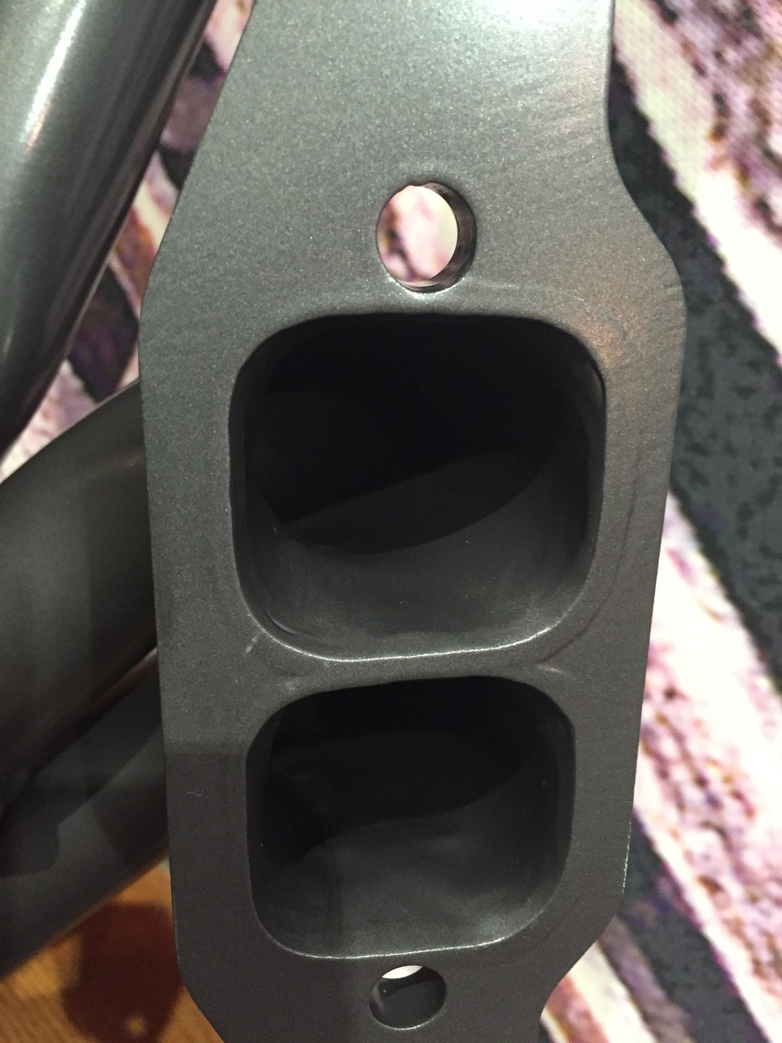

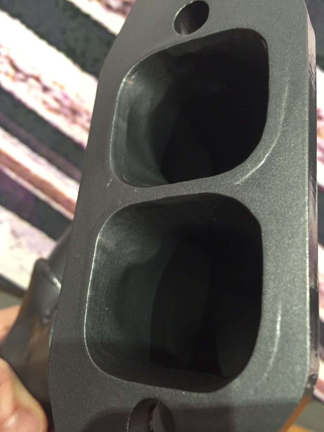

[QUOTE=duramaxsky;1594282352]Stans is a local shop here. They are the best there is around here. Quality is top notch.
Not local to me, but I too wanted to try the tri-y style for the potential mid range torque increase all the engineers have been singing the praises of since the mid 60s. (I only have 355 ci) Stan's were the most recommended. So I popped for the $$$. I don't have my engine running yet, but I can confirm the superb build quality. They are the best built set I have ever owned. I hope they do what I wanted for the torque below 5500 rpm, as I don't intend on drag racing THIS car.

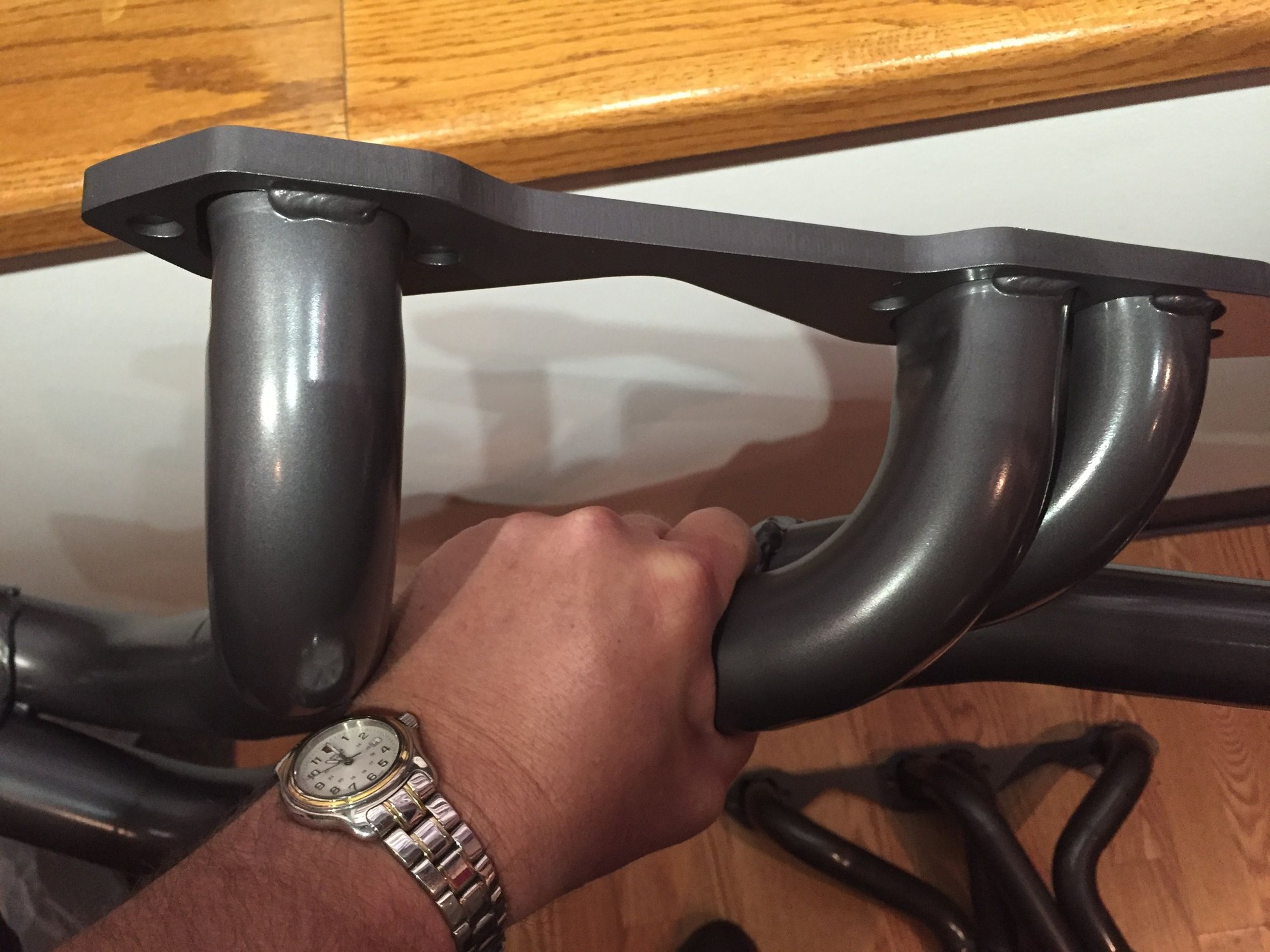

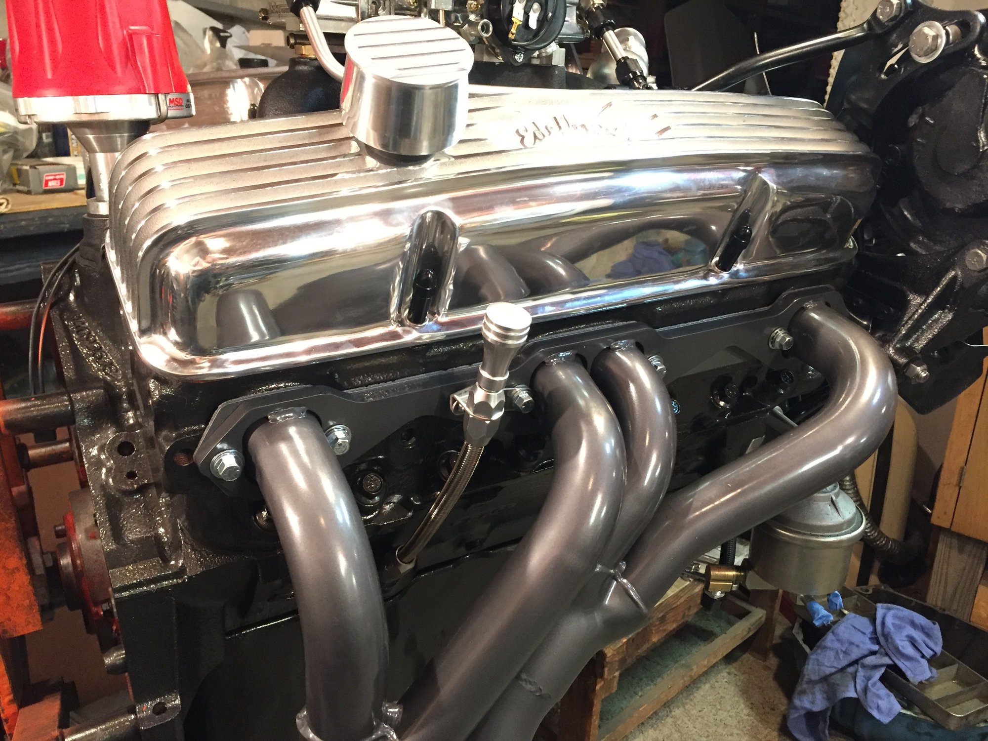

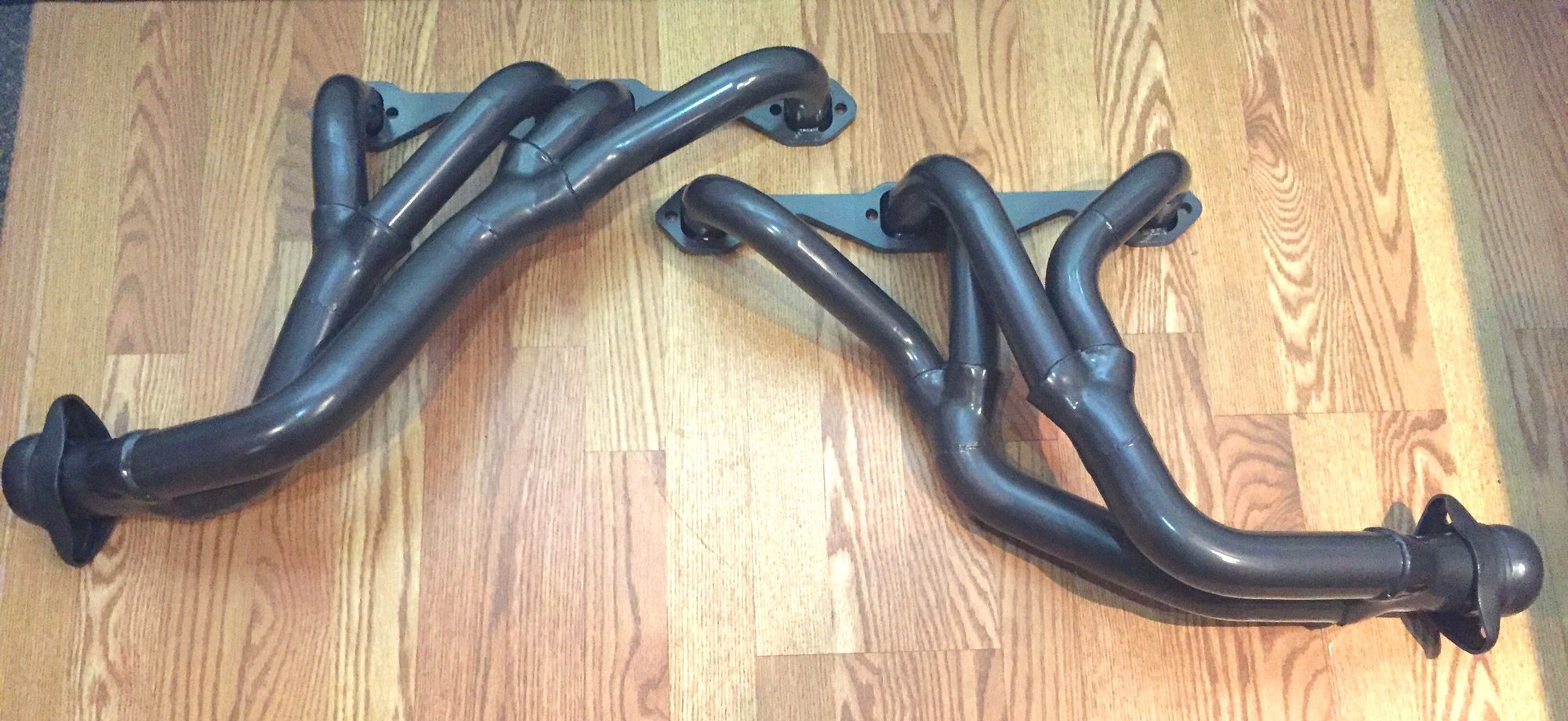

I was in San Jose last week so I drove up to Sanderson's shop in South San Francisco to look at their headers and came home with these
The quality is very impressive, everything is built right there in their shop. 16 ga. tubing, 3/8" laser cut flange and the welds are very nicely done, not like some of the cheap Chinese crap I have seen. I got the silver ceramic coating and they gave me a very good price on them, much better than ordering. They included collectors, bolts and even a tube of silicone caulk which they recommend instead of a gasket.
My project is slowly coming together.
