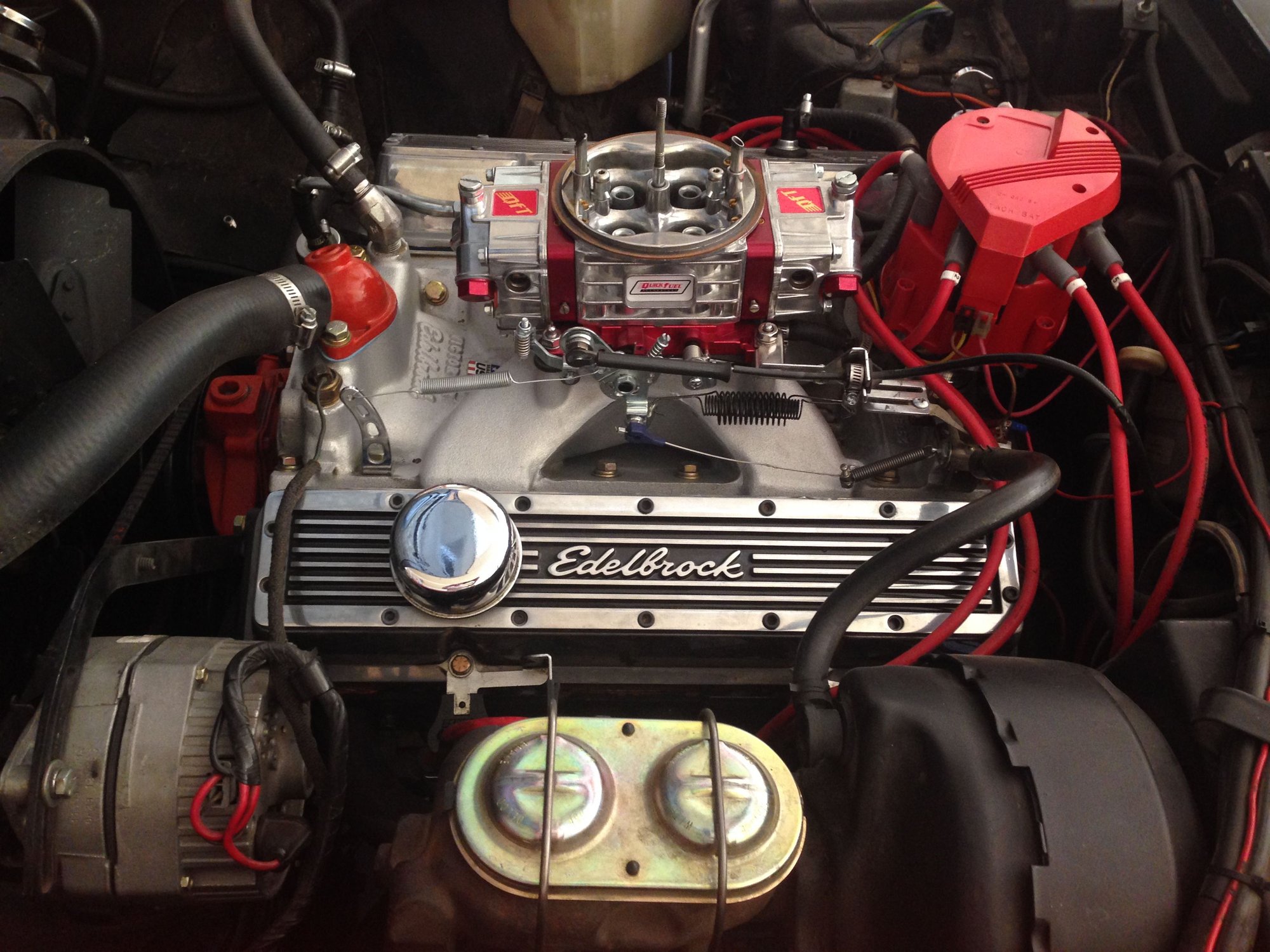

I live in Canada and do not have a choke . First one was a holley 650 now running Quick Fuel 750 . Just have to warm up for 2-3 minutes in mornings and good to go.

Qveld, that's exactly the kind of feedback I was looking for.
My buddy who I mention in the post said that Spring/Fall he has to keep the foot on the gas for a bit longer to keep it going, but in the summer he doesn't have a problem.
I'm definitely leaning towards a no-choke carb.
