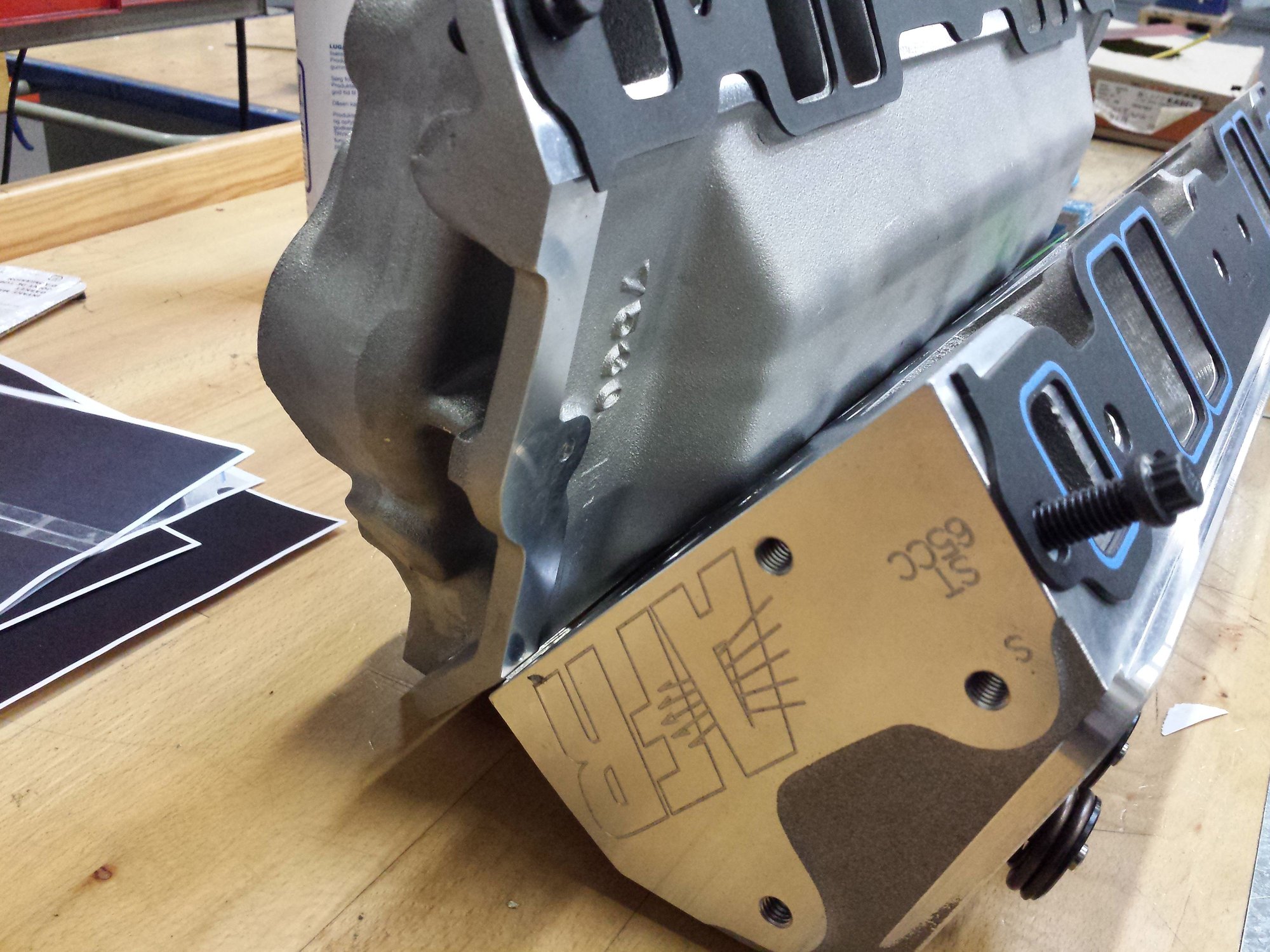

Here is my AFR 195 heads.

On a budget, I would keep the cam, change the heads, AFR 195s CNC ported are always a good option on a 383. Personally, I'd go with at least a 210cc if not even a 227cc (if you change cams). There are lots of other head options as well, you may should look to some of the import heads out there that are ported, machined, assembled by experienced head people like Slick Rick, Chad Speir, Scott Foxwell etc. You can get a better performing head then an AFR for around the same money or less.

x2 dont be afraid of a good 195 -210 head esp on a 383
The 210 comp port (not the street head) is a fantastic piece, same with the 195 comp
Leave the cam for now do the heads see where you sit do the 750dp youll like it. You should be in the 11s for sure;hp series, AED one or two others are pretty nice
